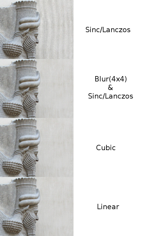

Hmmm. I remember testing the varoius methods in 2.6 after getting hit by aliasing in downscaling, and Sinc and Cubic did give different results.
<fumbles in the directories>
Yes here it is... also shows the effect of pre-blur:

I've discovered that pre-blur then downscale then optional re-sharpening if need be is the best way too ofnuts. Keeps aliasing issues down. :)

Well seems you are right, i remember to have followed a tread on the developer list were was explained why were not used interpolation methods when downscaling, but something must be changed from then.
Now i get all info i was needing, i just hope to maintain the focus the time sufficient to write the a filter
PS in your example blur 4x4 stand for gaussian blur of 4px on both axis ?
i ask because i experimented much lower values (very seldom more then 2 usually less as 1.5) to scale down at 50%
there is some simple way to calculate the best amount of blur ?

Yes, 4x4 is blur "4px" in Gaussian blur. Normally, you have to filter out any thing that is close to or smaller than one pixel in the final output. Which means that to downscale 4x, you have to apply a 4px Gaussian blur. Pretty simple, isn't it? In fact the actual Gaussian blur isn't applied in "pixels", but that "measure" of the blur pretty much indicates what it makes.
