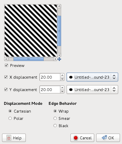

In v2.6 if you brought up the displacement filter (Filters > Map > Displace) and used default settings and set the filter to a blurred black & white layer, the displacement worked. This image is from a tutorial I did.
Now if I try to do it the same way, I get no displacement with the default settings. I have to change the X or Y displacement amount.
Image.....Image

First I tried it with a dingbat, then text, and resorted to a circle and they all came out flat in the preview window and the results unless I changed one of the settings as shown in the examples.
Has anyone else tried it?

Thanks for your input, Alc. I should have mentioned that I am using gimpv2.8.2 on Fedora 17, Linux.
Here is using the letter g and clicking the OK button using the default settings. There is an inset of the layers. This is after my computer was off for the night and booted up this morning.

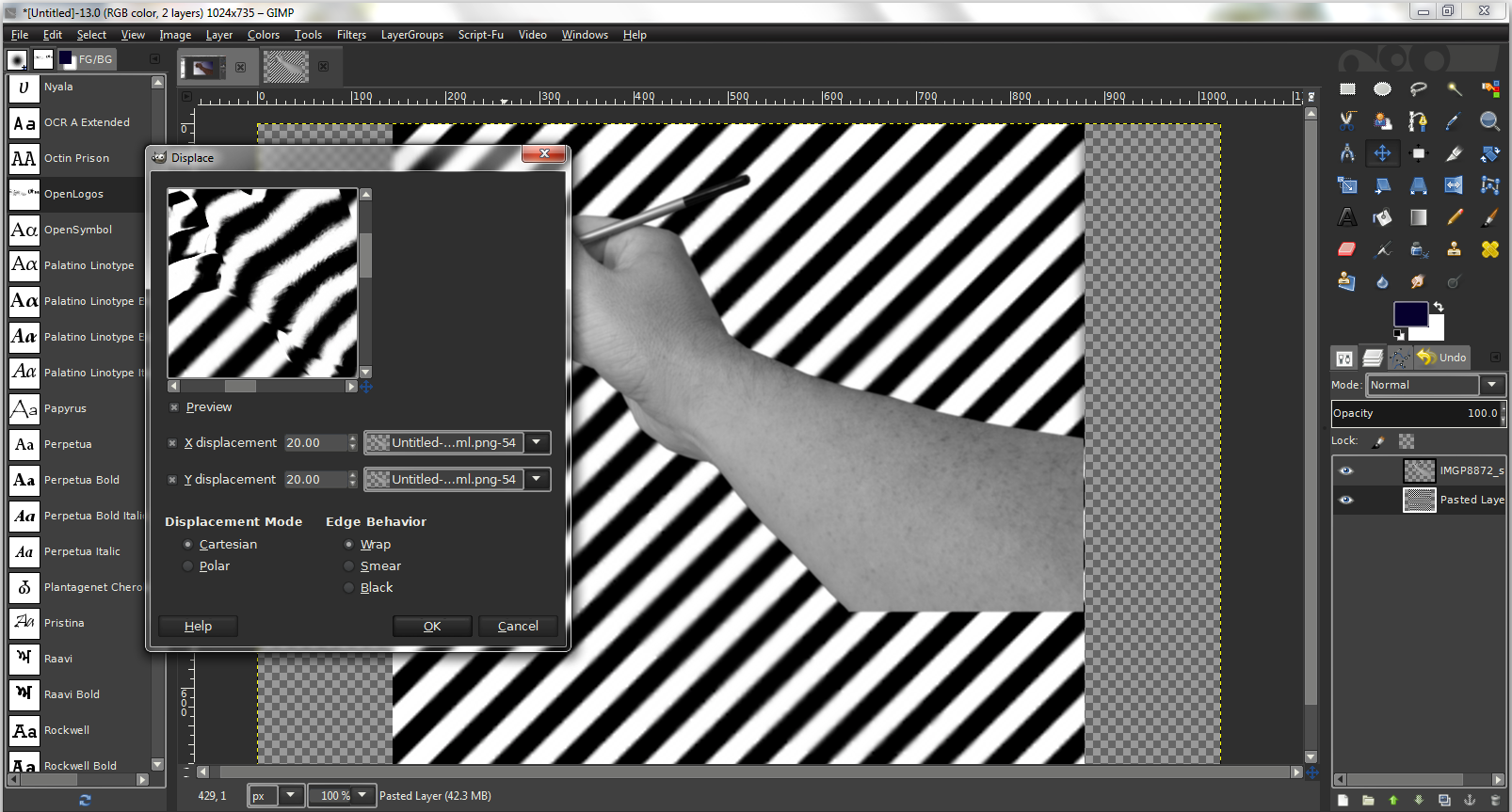

Hm. That's interesting that rotating it would work. I was using this tutorial with orange and black stripes using a jack o'lantern dingbat and when it didn't work, I just did the tutorial with the regular black and white gradient.
If anyone wants the "g" in the tutorial, it is the Century Schoolbook Bold "g" that comes with gimp.
Using alc's method, I flipped the stripes layer and displacement worked with default settings. This gets a bit weirder now. I will need to do that with my orange and black gradient also as displacement didn't work with it either.
Interestingly enough, I used the yellow and black warning stripes in the patterns and displacement worked fine.

OK, I think it has been narrowed down to gradients being the culprit. Making a narrow, 45-degree gradient, bilinear, triangular wave with adaptive supersampling, seems to make it not work. If the gradient is flipped either vertically or horizontally, the displace filter works.
