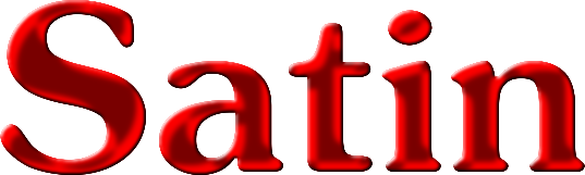

you can see the construction and endresult here:
i used: Tahoma Bold 200px, Offset 20/20; -20/-20, on Multiply 60%, Gaussian Blur: 15

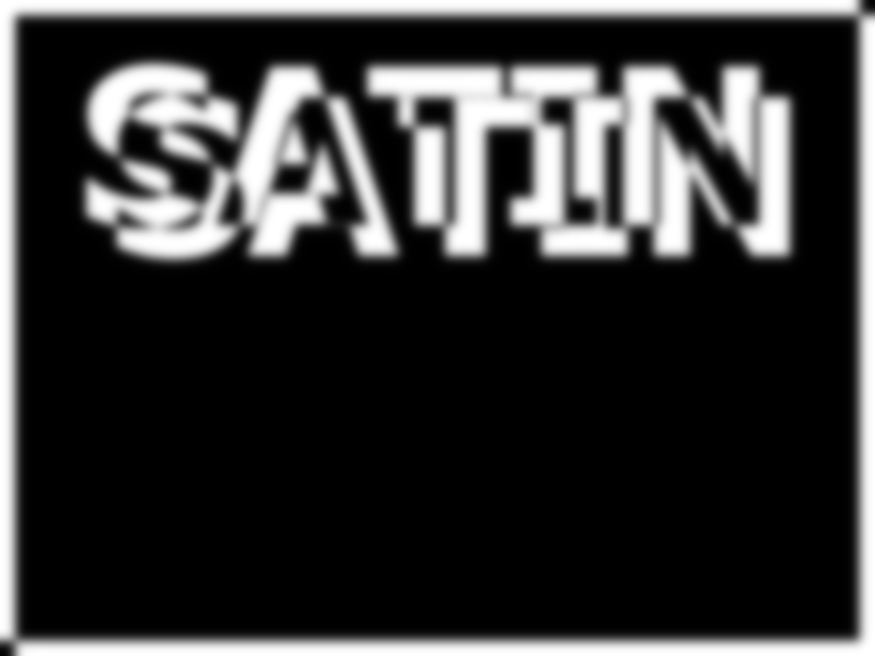

when you use the FX-Foundry Satin script, you get this layer with a layermask on top:

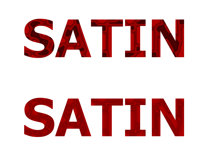

here is my first result:
text with satin effect and contours

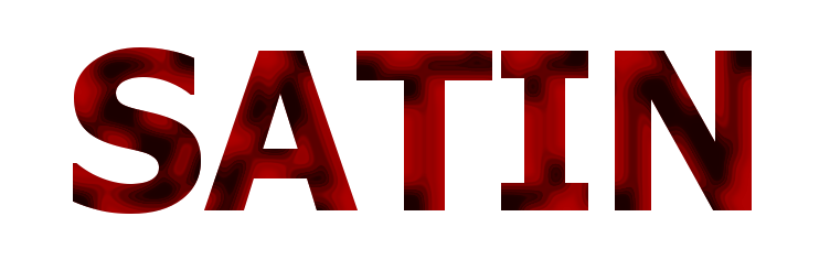

Iccii's Satin script adds a shadow to the centre of text, the only thing I have changed is to make the layer-mode of the final top layer hardlight
im not sure what you are saying here ...
are you saying you made the text the way i described and then added a shadow on hardlight ?
how did you add the shadow ? what offset did you use ?

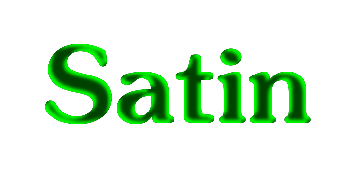

In examples below, was used plugin layerfx effects in Top image, and used shadows with offset by hand in botton image, and set mode to divide.
I dont know what is satin... but was reading and so tried.
bbbbbbbbbbbImage
