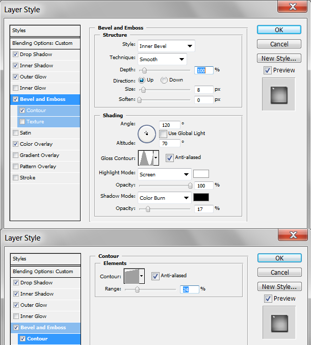

the cool thing about the PS effect, is that its all done with layereffects
the highlights are shrinked with an interesting curve, that doesnt seem to work in Gimp

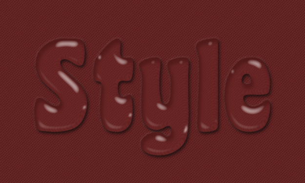

I played around with your gel text, Esper. I added an inverted drop shadow of X & Y = 0, blur = 30, Opacity = 100 and moved it below the bevel layers.
I used black text and then discarded it after doing the bevel and drop shadow.
I made the background, duplicated it and did alpha to selection and inverted and cut the top background layer.
Any here are my results.
I've added the xcf file of my layers if anyone wants to look.
geltextlayers.xcf [867.11 KiB]
Downloaded 161 times

PostPosted: Tue Mar 05, 2013 6:05 pm  (#16)
Wow, nice job.
 Post subject: Re: Gel/Water Effect Experiment
PostPosted: Tue Mar 05, 2013 6:21 pm  (#17)
Oregonian wrote:
I played around with your gel text, Esper. I added an inverted drop shadow of X & Y = 0, blur = 30, Opacity = 100 and moved it below the bevel layers..........
That's a beauty, Oregonian :bigthup
PostPosted: Tue Mar 05, 2013 6:39 pm  (#18)
O: that's really nice looking! very waterdrop-like.
PostPosted: Tue Mar 05, 2013 7:02 pm  (#19)
Thank you Molly, Odin and AnMal. I'm thinking we need to get Graechan making us a script for it.
