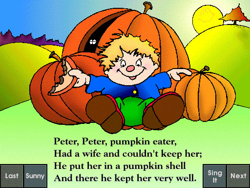

I have very old (circa 1995) computer art that is 256 colors. It is all cartoons.
The original high resolution art is not available. So I want to take the 256 color computer screen art and change it to millions of colors (24 bit) art.
But the original reduction to 256 colors resulted in dithering. In the sample image below, you can see the alternating pixel colors used to fake the appearance of colors not in the 256 palette.
What's the best way to take that 256 art and make the areas look smooth and not dithered? I'm a part-time software developer, not an artist, so I'm hoping for an easy solution in GIMP.

Ran G'MIC Wavelet denoise followed by G'MIC Bilateral denoise and re-introduced the smiley face. If you don't have the G'MIC filter, I suggest you get it; it's extremely powerful and should be a part of your toolkit. :)

The current stable Gimp (2.8) doesn't support any bit depth beyond 8 bit, though I don't believe you need a higher bit depth to smooth out the colours of a dithered cartoon image. The problem with your second image where the photoshop deblur filter was used, is that the suns face is blurred out. I got the same result with G'mics filters, but there an easy way around this.
Make sure you have the latest stable Gimp 2.8 and the latest G'mic installed.
Open your image. Upscale your image by 300%. Make a selection around the suns face and go to "selection--->invert". This will ensure that the suns face area is not affected by the filtering process. Here's a before image with the undesired dithering:
Open G'mic, open category "Repair" and choose "Smooth [bilateral] and apply it with the default settings. In the same category, choose smooth [thin brush] and also apply it with the default parameters. These filters are smart and do their best to avoid detail areas and only affect colour areas. Finally, go to colours----curves and apply the below shown setting to get the variation between the tones back:
This should be your result:
Now scale it back down with the cubic re-sampler to it original size (512 x 384 px):
