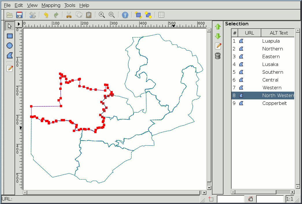

Filters->Web->Save Path(s) as HTML poly map...
http://chiselapp.com/user/saulgoode/rep ... th-as-poly
  • Make your selection
  • Convert it to a path ("Select->To Path")
  • Use the script to save your path(s) to a .map file
  • Open the Image Map plug-in
  • Open the .map file

saulgoode wrote:
:ninja :ninja :ninja
http://chiselapp.com/user/saulgoode/rep ... 481446c96b
Poor Saulgoode ninjad thrice trying to post this fabulous new script. Nicely done Saulgoode! That was very quick by the way. :) :bigthup

@saulgoode - many thanx to you - will apply to the problem in due course and will post to the forum if any issues arise.
