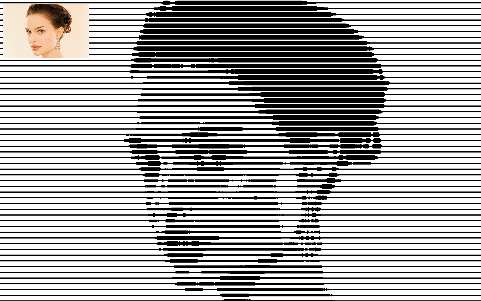

Just a quick try here with ai

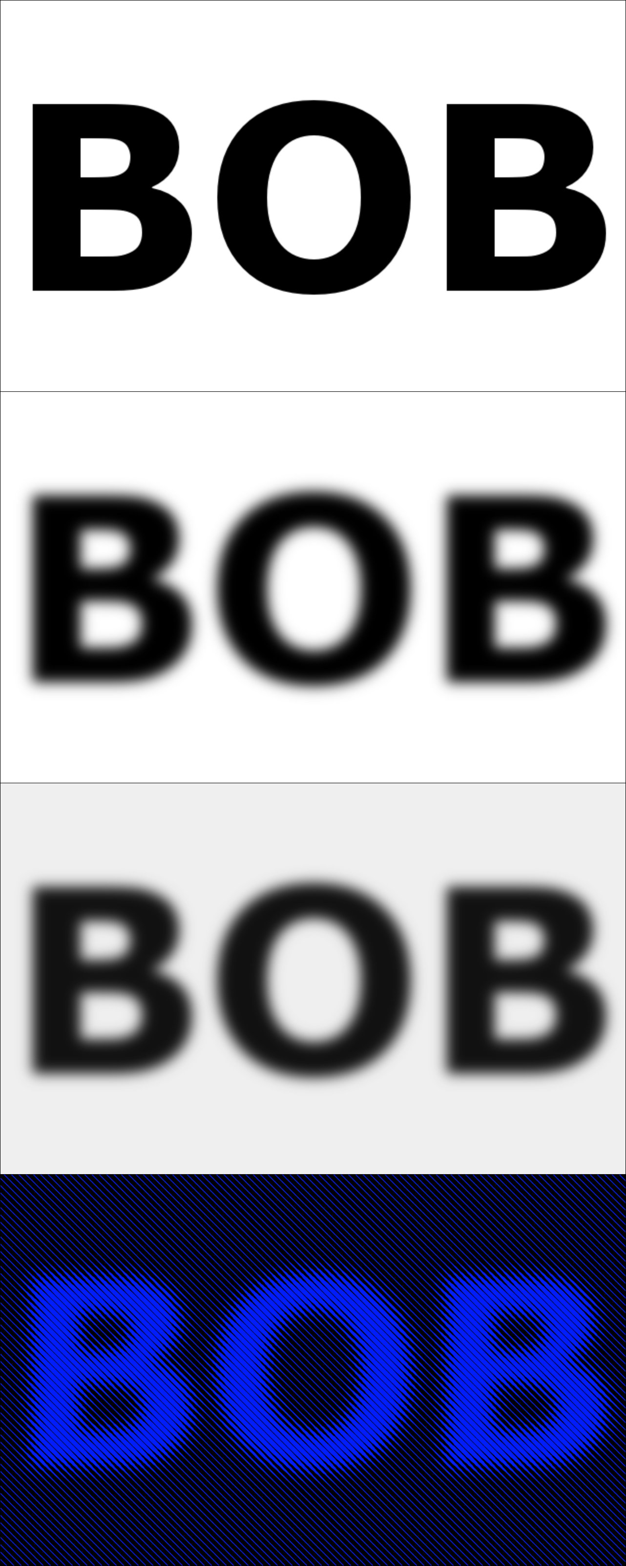

You can use my greyscale dither script:
http://silent9.com/incoming/scripts/gre ... dither.scm
It does work best if you enlarge the image first. The larger you pre-blur, the more gradual the lines widen.
This sample I used map black to blue and white to black (in the script options) and picked the greyscale compensated selection.
Here is the dither pattern I created for this:
pattern.png [ 449 Bytes | Viewed 6778 times ]
You can get many more greyscale ditherhalftone patterns that can be used from here: http://gimpstuff.org/content/show.php/d ... tent=81817
-Rob A>
