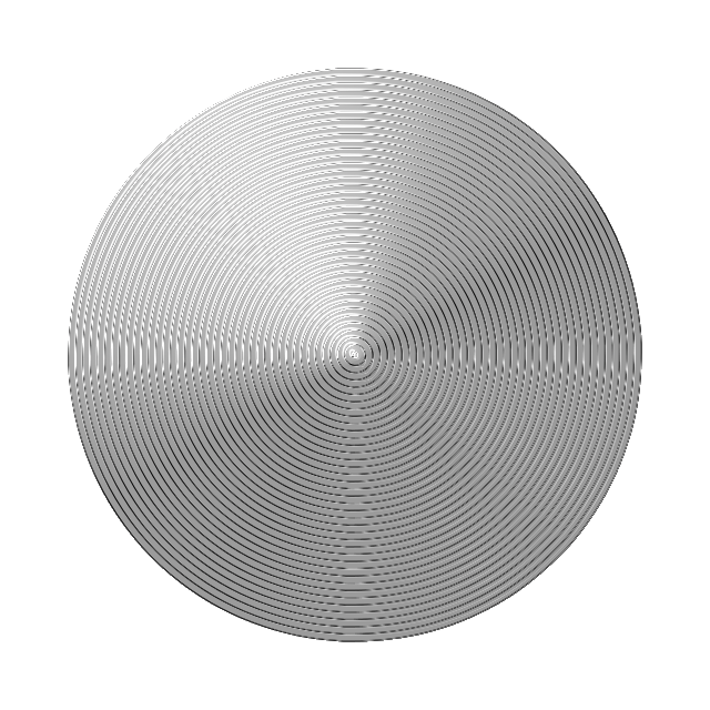

Gave it a try using concentric circles generated using generate new paths python plugin and conical gradient target as a target displacement layer. :)

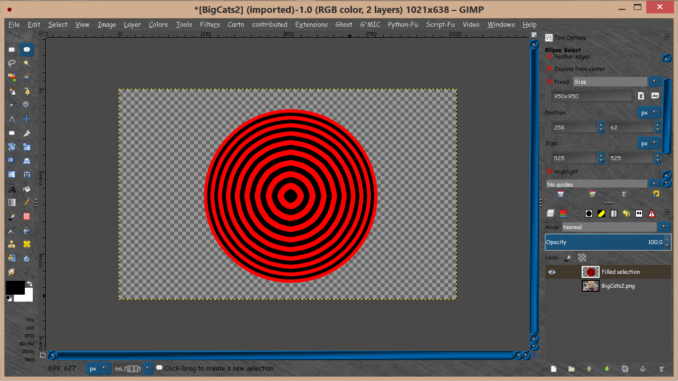

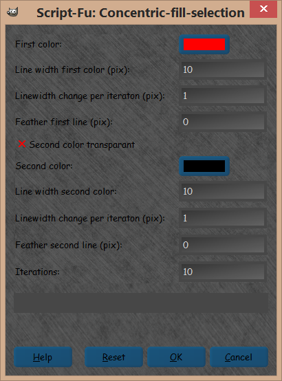

There is a script here. It is actually fill selection with concentric selection. :)
viewtopic.php?f=9&t=6923
Works ok in GIMP-2.8.14
My settings
