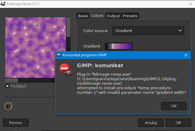

This is the error I'm getting when I try to change the gradient in "Bevel Reflect Logo"
 Post subject: Re: 2.10.18 is out!
PostPosted: Mon Feb 24, 2020 8:35 pm  (#5)
Maybe someone should fix the plugin instead... This is a problem with the plugin (you can't have a space in a parameter name, and this was already like this in Gimp 2.8).
Not true. It's a problem in GIMP's code as found in this issue: https://gitlab.gnome.org/GNOME/gimp/issues/4682
Where it shows that in gimpfontselect.c
  static const GimpParamDef args[] =
    { GIMP_PDB_STRING, "str",           "String"                     },
    { GIMP_PDB_INT32,  "dialog status", "If the dialog was closing "
                                        "[0 = No, 1 = Yes]"          }
And some code elsewhere takes the string "dialog status" and tries to use it as a parameter name, which won't work as it has a space character in the middle. How it ever worked in the past is a puzzle.
