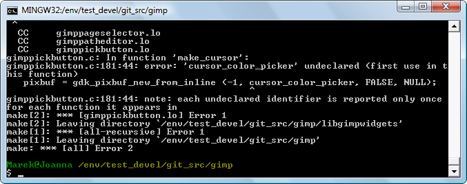

Hi Rod.
For me, two serious problems make:
My Paint brushes: no (libmypaint-gegl not found)
X11 Mouse Cursor: no (libXcursor not found)

Hi all,
I can't give much advice on compiling GIMP on Windows. When I build it *for* Win, I do it as a cross-compilation from a Linux machine (and that is very easy, I even made a very cool tool for the crossbuild job called "crossroad").
I just wanted to do a remark though for once you managed to compile GIMP master. Both the multi-stroke and the mypaint brushes are "hidden" tools. You must activate these from the playground. Go in Preferences > Playground and there check any tool that you want to test. This is the new politics of development, we first push new tools to the playground and leave them there until we consider them stable enough. :-)
Also for building on Win, there are a few methods listed on the GIMP wiki under wiki/Hacking:Building/Windows (I unfortunately can't give a direct link, I don't have the right yet).
