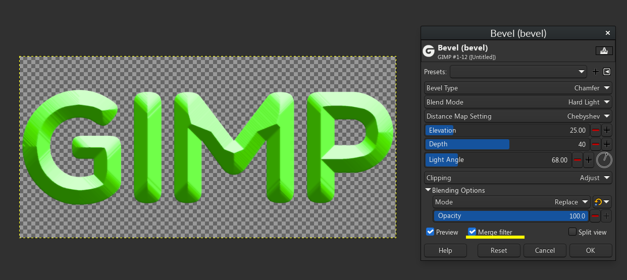

GIMP 2.99.19 just got the ability to apply filters destructively just like 2.10 does with this new "merge filter" checkbox. Now my resource intensive plugins will not add to memory to GIMP's cache. Also, GIMP 3 RC1 is right around the corner.
I like it! Going to save on memory big time! :bigthup
Nice to have both options Non destructive and merge filters.

    (script-fu-add-bevel image drawable bevel FALSE FALSE)
    ;(script-fu-add-bevel image original bevel FALSE FALSE)
  (gimp-image-add-layer image bg-fill 0)
  (gimp-image-lower-item-to-bottom image bg-fill)
  (gimp-context-set-foreground mycolor)
  (gimp-drawable-fill bg-fill FILL-FOREGROUND)
  (gimp-image-raise-item image original)
  (gimp-drawable-set-visible original-copy TRUE)
  (plug-in-gauss RUN-NONINTERACTIVE image original-copy 4 4 1)
  ; (plug-in-lighting RUN-NONINTERACTIVE
                    ; image            ; input image id
                    ; drawable          ; input layer id
                    ; original      ; load bumpmap? 0 = DISABLED name = enabled
                    ; 0                ; load env map? 0 = DISABLED name = enabled
                    ; TRUE             ; enable bumpmaping (TRUE/FALSE)
                    ; FALSE            ; enable env maping (TRUE/FALSE)
                    ; 0                ; Type of mapping (0=linear,1=log, 2=sinusoidal, 3=spherical
                    ; 0                ; type of light src 0 = point
                    ; '(255 255 255)   ; light src color is white
                    ; 0.57 -1.27 1.00   ; light position 1 xyz - alt 0.57 -1.27 1.00 or 0.53 2.20 1.00 works
                    ; -1.00 -1.00 1.00 ; light direction 1 ijk - alt
                    ; 1.00             ; Material ambient intensity (0..1)
                    ; 0.20             ; Material diffuse intensity (0..1)
                    ; 0.50             ; Material diffuse reflectivity (0..1)
                    ; 0.50             ; Material specular reflectivity (0..1)
                    ; 27.0             ; Material highlight (0..->), note: it's expotential
                    ; TRUE             ; Apply antialiasing (TRUE/FALSE)
                    ; FALSE            ; Create a new image (TRUE/FALSE)
                    ; FALSE            ; Make background transparent (TRUE/FALSE)
          ; end
  (gimp-selection-none image)
  ; display new image and return user settings
  (gimp-context-pop)
  (gimp-image-undo-group-end image)
  (gimp-displays-flush image)
    ;register menu location and information
(script-fu-register
"script-fu-chewed-text_RD"
"<Image>/Rod/Alpha to Logo/Chewed Text Effect"
"creates a Chewed Effect on an alpha or text layer  -  script name: chewed-text_RD.scm"
"Rod Detmer"
"Rod Detmer"
"December 2015"
"RGB* GRAY*"
SF-IMAGE       "The Image"            0
SF-DRAWABLE    "The Drawable"         0
SF-COLOR       "Background Color"        '(255 255 255)
SF-COLOR       "Shadow Color"        '(70 30 20)
SF-PATTERN      "Select Pattern"          "Seamless-burger_RD.png"
SF-PATTERN      "Select Mask Pattern"     "Shredded-Text-Mask #1"
SF-ADJUSTMENT "Bevel Amount"         '(20 0 30 1 10 0 SF-SLIDER)
SF-ADJUSTMENT "Chewyness"         '(-3 -1200 1200 1 10 0 SF-SLIDER)
By the way do you know why there isn't a refresh scripts under the <image>/filters/development/script-fu/ menu label?
