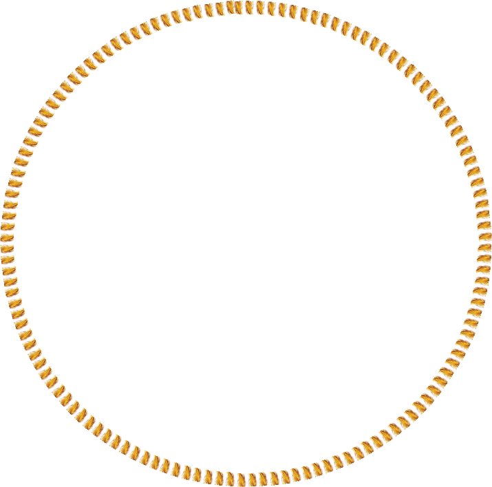

Didn't feel like starting a new thread to sing the praises of the new version of GIMP. Anyway, this is why I like brush dynamics. Created a circular path and stroked the path. The brush was a 20 position gih brush; changed it to a single layer gih because of brush dynamics. Not saying there will never be a reason to created multi-layered rotational gih brushes; may want to control the limit of the angle for whatever reason. Still, brush dynamics is a game changer for me. :)
 Post subject: Re: 2.8 RC1 for windows released
PostPosted: Sun Apr 15, 2012 6:30 pm  (#29)
Might well have some uses I hadn't thought of. Mmmm... my imagination's going now. Thanks Lyle!

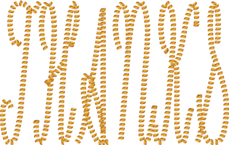

Thanks Erisian. Used ofnuts unclose path python plugin and a machine font to create the paths for this one. Then, of course, stroked the resulting path. :)
