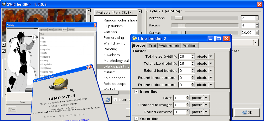

Finally, have experienced a version of GIMP (regular 2.7.4 32 bit) which works: G"MIC, Mathmap, all python plugins (after a small addition to the libraries - tcl;pygtk), APNG and PostScript (pdf, ps, eps) of gs902w32.exe.
PARTHA - big thanks.
