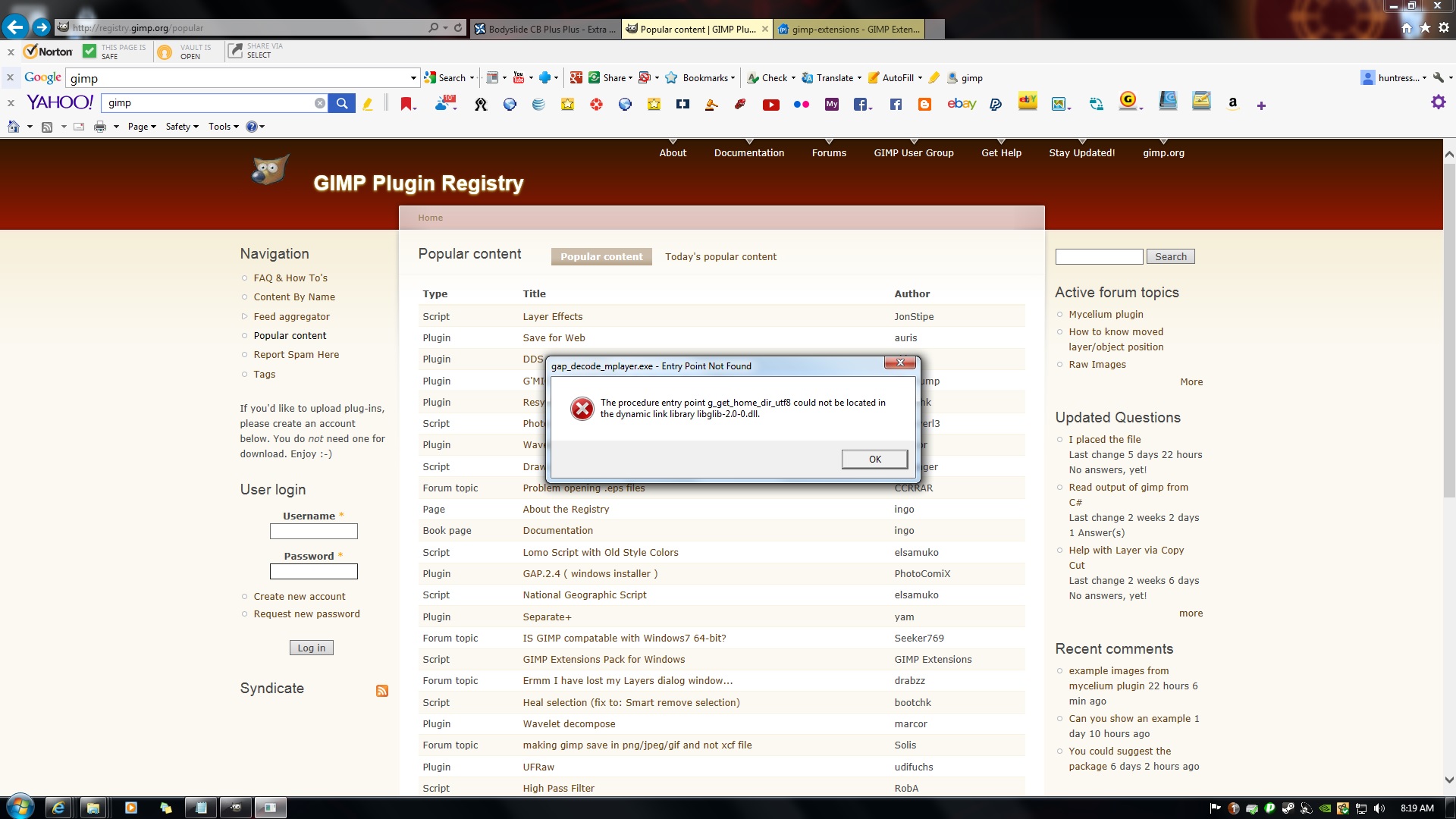

I'm having a similar problem. I DLed and installed gimp 2.8.10 64bit and a first it worked fine, but after installing like 3-4 plugins I started getting this error:
File comment: Pic of the error I get on gimp startup
and I am not sure what I did to break it. Heres a list of the few plugins I have installed:
gimp-dds-win64-3.0.1
photo-effects_20
GIMP_Extensions_v2.8_latest
enviromap.scm
layerfx.scm
and that's it, not sure if one of the plugins broke it or what? Though I am also getting this message when I refresh script-fu:
File comment: Message I get when refreshing script-fu scripts.
any help you could offer would be appreciated. Also wanted to note that this is a brand new pc, so it has never had any other versions of gimp on it.

The first error (not found entrypoit g_get_home_dir_utf8) seems to be an error of an older glib-2.0
The current one is delivered with gimp, so I think you have an other, older glib-2.0 anywhere in your path.
For the second error, please open a command window, change to the gimp/bin directory and start gimp with 'gimp-2.8.exe --verbose' (without the " ' "). There maybe it can be seen by an error, why the script could not be loaded.

Well I figured out what part of gimp extensions was throwing "the procedure entry point g_get_home_dir_utf8" error message, it was GAP, the animation module, so I uninstalled gimp extensions, then reinstalled but made sure not to check any of the boxes for the GAP, finished installing everything else, and started up gimp. Started up with no error messages yay! And I can still use the rest of the gimp extensions packages, like G'MIC and FX Foundry, etc. Woot!! :D

Well thank you, that just helped me get through "The Procedure entry point g_get_home_dir_utf8 could not be located in the dynamic link library libglib-2.0-0.dll"
Regards,
Tom C
More than likely you installed a older glib dll file when installing the GIMP extension filter set of GAP. This is why you need to be careful installing anything from a third party other than gimp.org. You probably installed a duplicate scm file also and GIMP saw two as none due to same script name errors.
