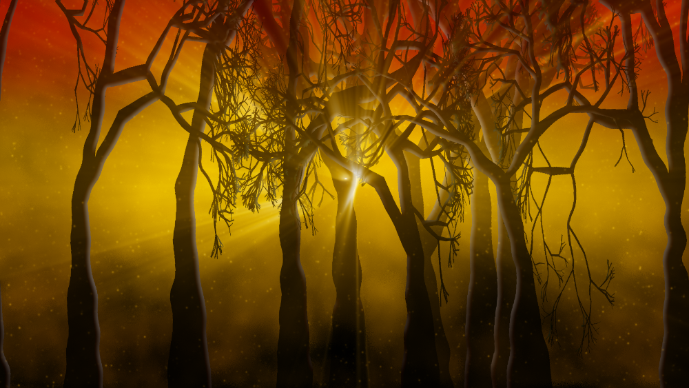

Has anyone tested as underwoods in G'mic
very surprising

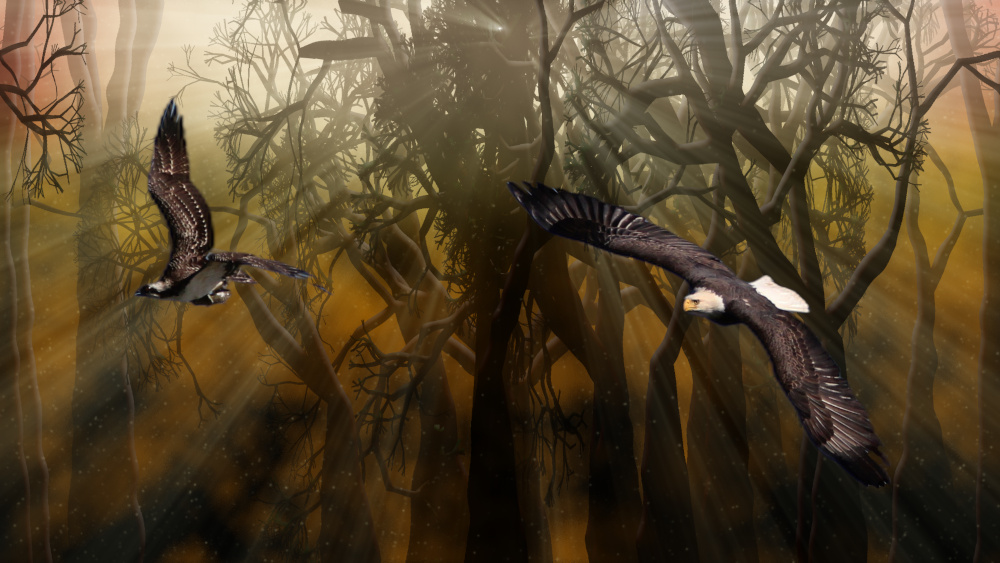

This makes for a pretty good backdrop for my Eagle chase image.

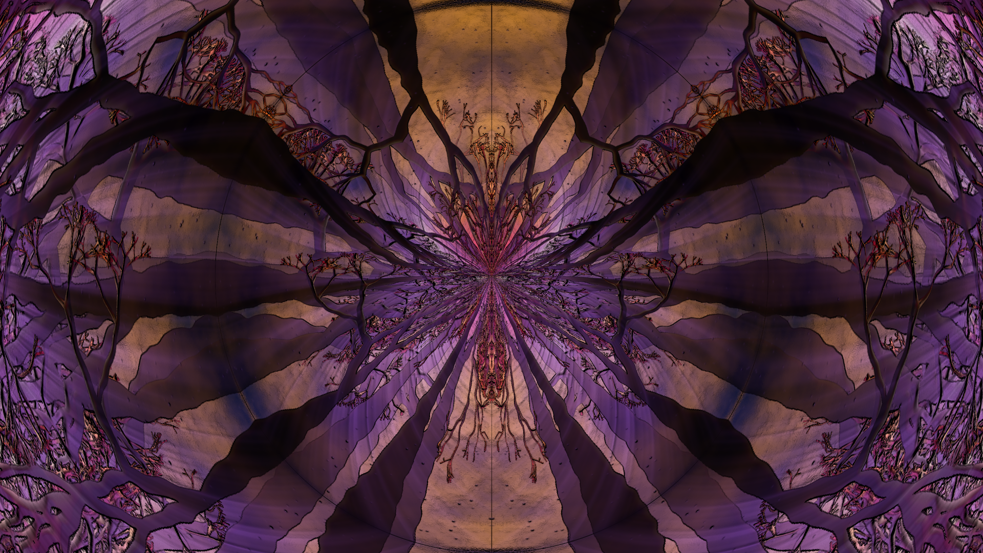

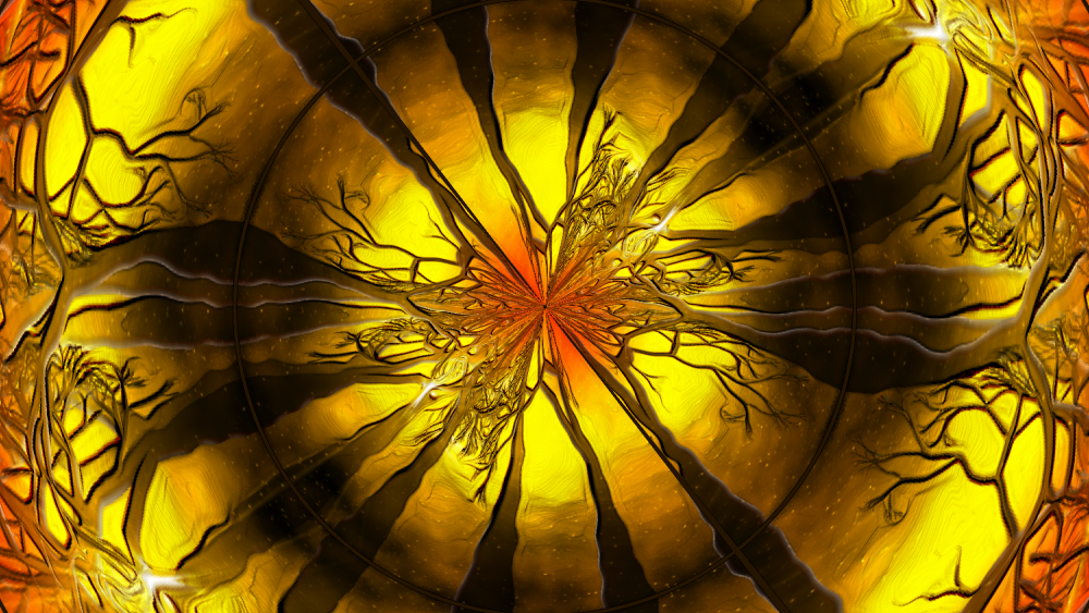

playing around with underwoods > kaleidoscope

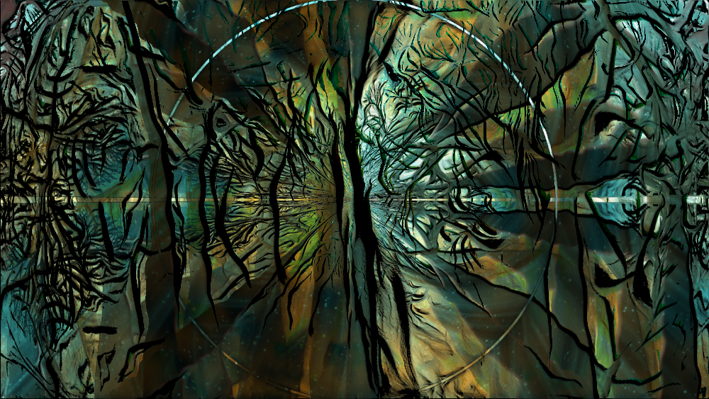

G'mic> Rendering> Underwoods (624 filters in g'mic))

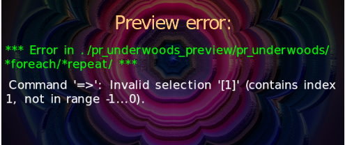

Only worked for a few days here.
Now it's throwing this error:
Preview error:
*** Error in . /pr_underwoods preview/pr underwoods/*foreach/*repeat/ ***
Command '=>': Invalid selection ‘[1]' (contains index 1, not in range -1...0).
Settings are default:
pr_underwoods 0,30,50,5,10,10,0.7,208,208,156,34,500,1,255,255,255,0.4,0,0,10,4,2,0.4,0,20,15,10,0,1,15,10,0,0.8,100,0,0,40,30,0,40,20,0,20,10,0,0,0,0,0.2,34,0
Hopefully the next GMIC Update can repair this.

Now I continually receive the same error message as quietreader.

The crucial point seems to be the output mode at the very bottom.
If I set it to "In place" it works ... any other output mode doesn't work here.

it still wants to output as "in place" here.
Messages that I get (with output set to "new image") :
[gmic_gimp_qt]./preview/ pr_underwoods_preview 0,30,50,5,10,10,0.7,208,208,156,34,500,1,255,255,255,0.4,0,0,10,4,2,0.4,0,20,15,10,0,1,15,10,0,0.8,100,0,0,40,30,0,40,20,0,20,10,0,0,0,0,0.2,34,0
[gmic_gimp_qt]./error/ When running command 'pr_underwoods_preview 0,30,50,5,10,10,0.7,208,208,156,34,500,1,255,255,255,0.4,0,0,10,4,2,0.4,0,20,15,10,0,1,15,10,0,0.8,100,0,0,40,30,0,40,20,0,20,10,0,0,0,0,0.2,34,0', this error occurred:
[gmic_gimp_qt]./error/ *** Error in ./pr_underwoods_preview/pr_underwoods/*foreach/*repeat/ *** Command '=>': Invalid selection '[1]' (contains index 1, not in range -1...0).
Has it downloaded the update at all? Its date is still April 15
