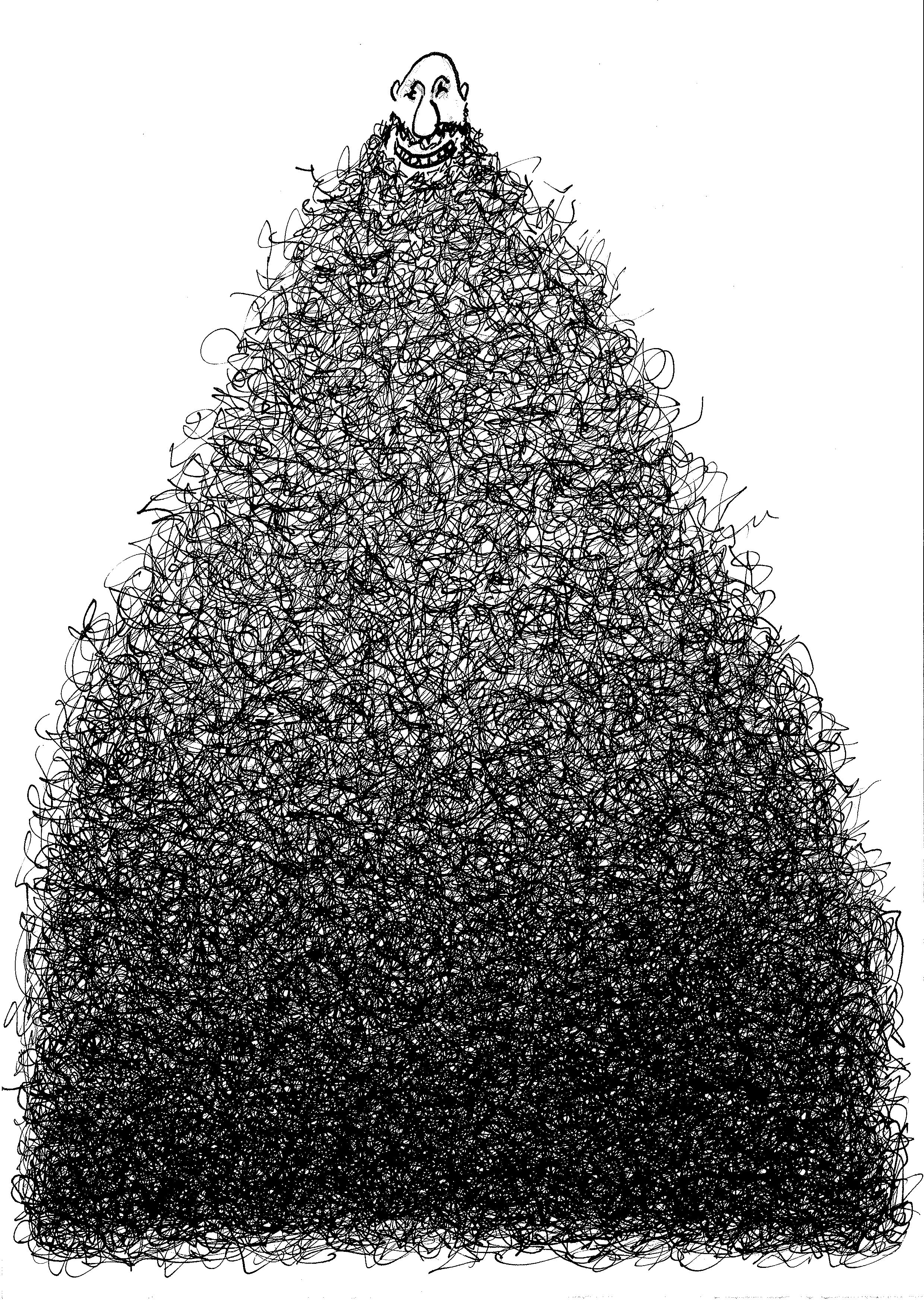

I have a scan of a black-and-white pen and ink drawing made by me. The scan was saved as tif.
I need to remove the white background from the drawing. Whenever I have tried I get a white line drawing on a transparent background. The file does not seem to be acting normally.
So far, no tutorial on youtube has solved the problem.
Any help appreciated.

If as you say you get a white line drawing - have you tried inverting the colour to see what you get?
Do you mean when you try 'colour to alpha' that all of the white goes.
Your edges of a picture need to be complete to just get rid of the background.
You could do a selection around your picture with free select then invert, path tool then turn that into a selection then invert and even the foreground select inverted - actually you get a couple modes now so you can probably do background.
After getting your selection then colour to alpha and just that area will be transparent

Set the bucket-fill tool to `Color erase` mode; and `Fill whole selection`. Bucket-fill the image with white.

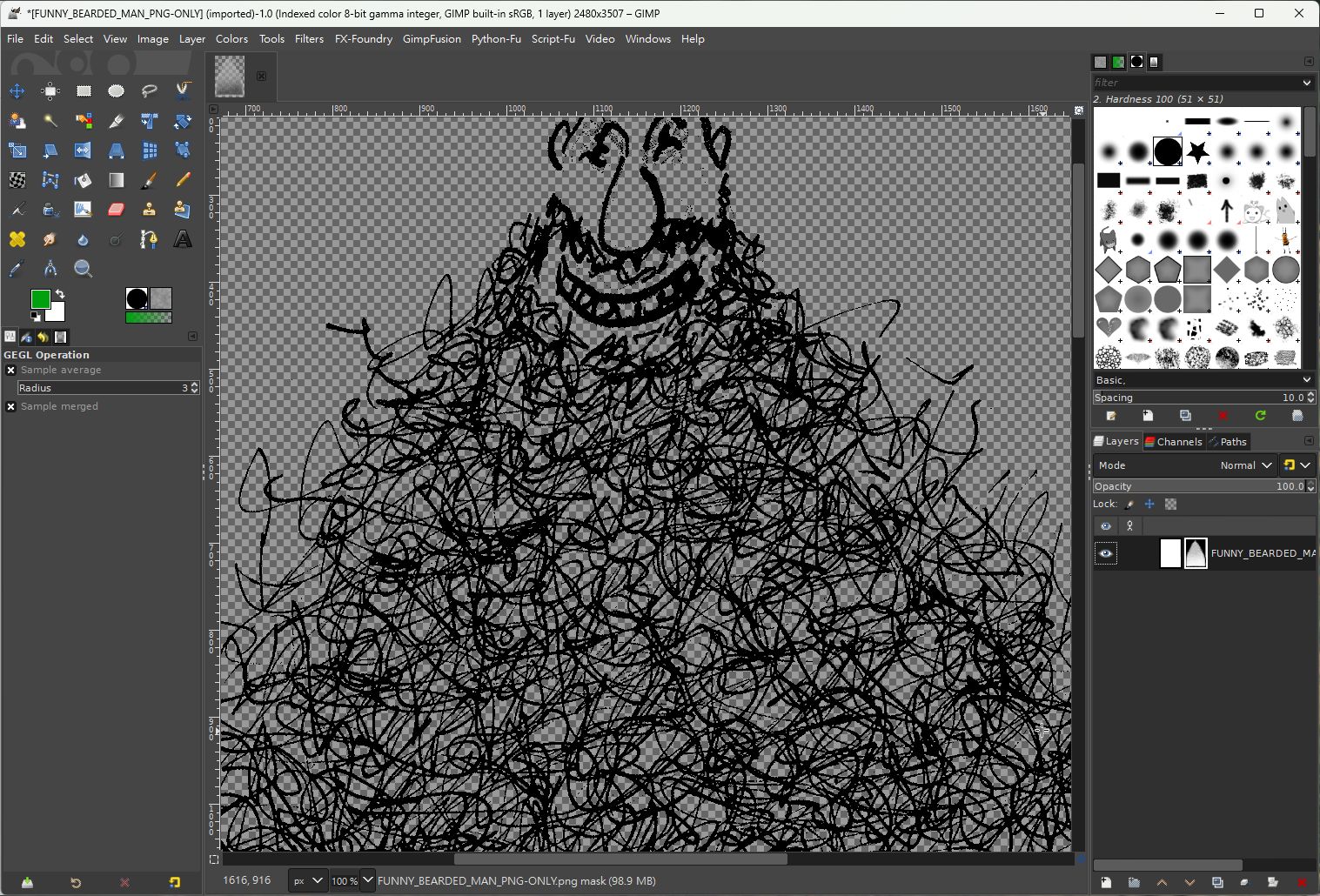

Here is my try
1. Add Alpha Channel
2. Add Layer Mask ...
Result

See attached

See attached
thank you for sending me this.
I saved it to desktop and opened it and it was completely black. I guess that means black drawing on a black background, not the checkered background that means transparency. I got some results like this in my own tests.
but when I opened it in gimp it had the transparency background so this may be usable.

Haven't used TIF in a long time and didn't recall it being able to save alpha information. Best to save in PNG format; more universally accepted, imo. As for removing the white background, ofnuts explained it well. Can also try color to color to alpha (defaults to white for erasure). :)
I just tried color>color to alpha
the drawing after being saved is coming out a white drawing on black. maybe good for a christmas card. But thanks for the suggestion anyway. I just attached it here, but it is barely visible. I was playing around with opacity and transparency settings.
