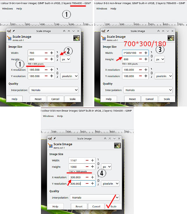

Part 2 ;) It is not very obvious in the Image -> Scale Image dialogue how to get from one ppi to the corresponding background layer ppi.
There is information as to pixel size in Gimp (1) By default values are linked (2) leave it like that
Gimp will do the arithmetic for you (3). Apply the ratio to the width - example is times 300 ppi divided by 180 ppi - *300 /180
Then change the resolution to suit (4) , and do use one of the better interpolation methods.
Confused ;) this a one minute animation of that: https://i.imgur.com/bCOdTpD.mp4
...and checking sizes with Image -> Print Size before and after.
