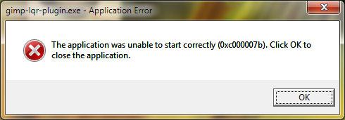

I get this error Rod; usually I get this when a dll is missing. Seen it before anyway. :)

Lyle try placing this dll file in your bin folder.

That was it Rod; I indeed had the liblqr-1-0.dll but mine was 240K and yours only 89K. Mine may have been the 64-bit version since I believe I was indeed using the 64-bit version compiled. Thanks a heap. :)
