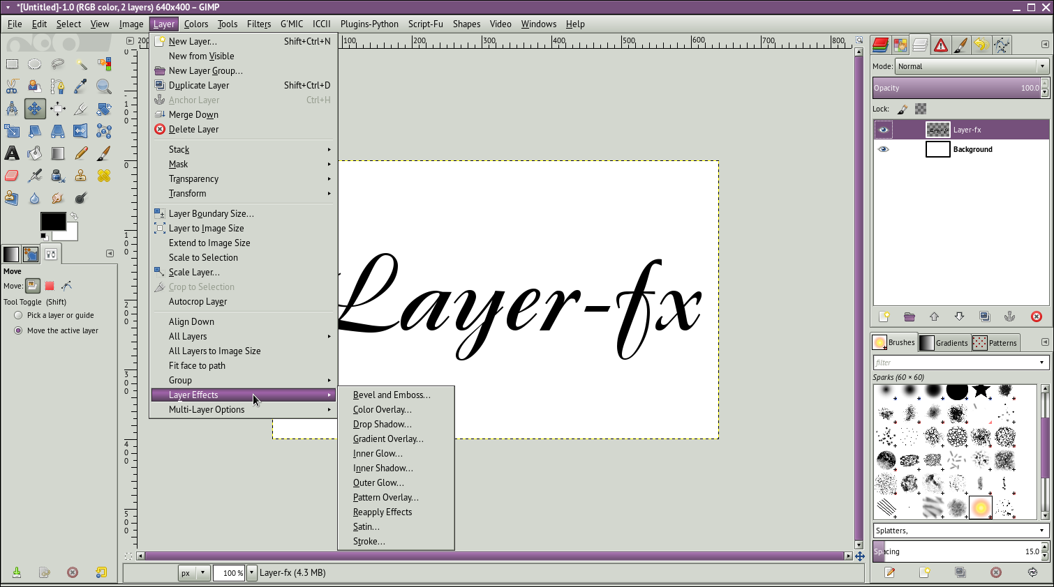

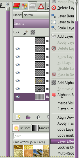

I deleted layerfx-2.8 months ago. I replaced it with layerfx. Now why is the 2.8 one still showing in my Gimp. This is a real poser.
Below is a screen of my mollys-plug-in folder, then a screen of the dialogues of them both stilll showing.

The older layerfx.py registers itself twice, lines 5731 and 5732
comment one of the lines out.

You can comment one line out with a # as in that screenshot of mine, but the 2 locations are not any problem, I would just leave 'as-is'.

Layerfx shows up for me twice as well. I never noticed before that it was part of the right click layers menu before. Something new learnt today :cool
