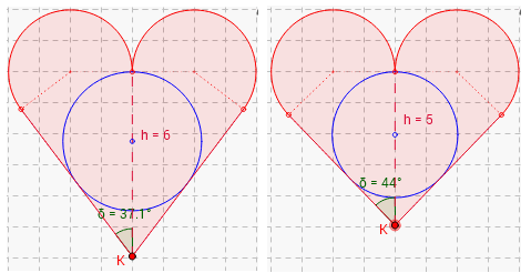

or this shape Pat
TinT
 Post subject: Re: Drawing arc path using Python.
PostPosted: Thu Sep 29, 2016 2:45 am  (#13)
This heart has a classic look - if You wrote code?
One more parameter - the dependence of H
For me, a long way to learn. :oops:
