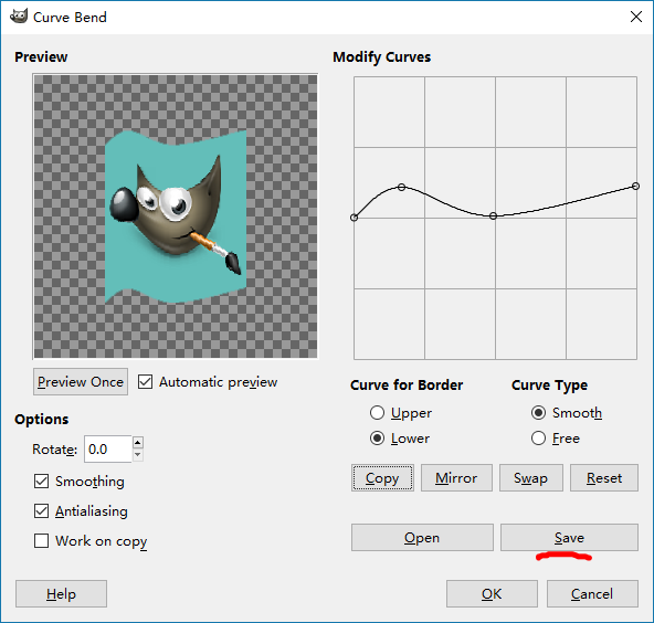

Hi
I am trying to use a script called distortions, so I save the curve node down, then adjust parameters, but is wrong, please help me to see what was wrong.
Thank you
testscm.zip [2.86 KiB]
Downloaded 269 times
 Post subject: Re: How to set the plug-in-curve-bend parameter in SCM
PostPosted: Thu Sep 29, 2016 9:30 am  (#2)
Posts: 16164
(define (curvetest image
              drawable)
  (let* (
         (type          (car (gimp-drawable-type-with-alpha drawable)))
       (alpha (car (gimp-drawable-has-alpha drawable)))
PostPosted: Thu Sep 29, 2016 9:31 am  (#3)
Posts: 16164
    (plug-in-curve-bend 1 image drawable 0 TRUE TRUE FALSE 0 '17 (upper-point-x) '17 (upper-point-y) '17 (lower-point-x) '17 (lower-point-y) '256 (upper-val-y) '256 (lower-val-y))
PostPosted: Thu Sep 29, 2016 10:30 pm  (#4)
Joined: Feb 21, 2016
Posts: 34
Thanks Rod
I have been using GIMP-curves-spline array is parenthetical, now forget the parentheses, thanks for your help.
PostPosted: Fri Sep 30, 2016 5:36 am  (#5)
Posts: 16164
Thanks Rod
No problem. Be interested in the script when you finish it. :) :bigthup
