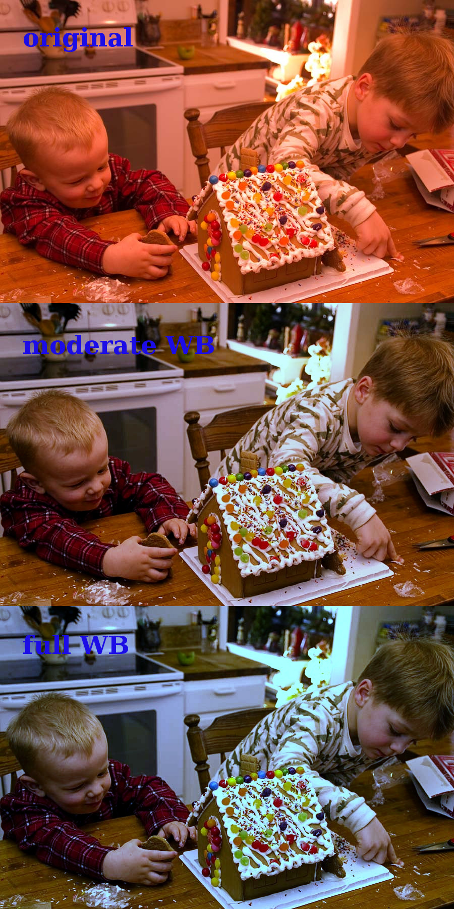

Changes introduced in this release:
- fixed a bug (flatten was wrong, merge_down now used)
- added user's choise between Full or Moderate effect
- Moderate uses mid value instead of avg
introduces a percent of application (internal)
adds a dup+pixelize+invert and overlay
 Post subject: Re: new filter "WhiteBalanceStretch2"
PostPosted: Wed Dec 21, 2016 9:39 am  (#51)
You may have here a look at the different outcomes between Full and Moderate
The last test version did, but in 1.1 I don't see this layers. Is that right?
PostPosted: Wed Dec 21, 2016 9:53 am  (#53)
merged down

I think it is very nice for an automatic white balance
