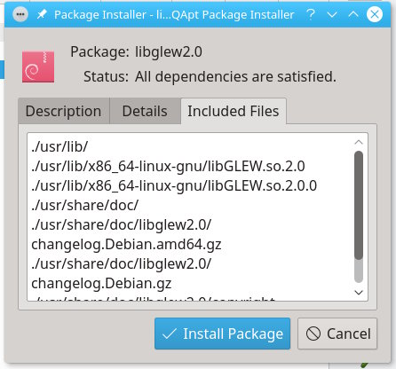

You do not download anything. The .deb file will install some files, a library file and some documentation.
You should have seen some thing like this. Hit the install button and it is done. Not required again.
The 2 files insanebump.py and normalmap both go in ~/.gimp-2.8/plug-ins. Both should show up in Filters -> Map. Check that they are executable.

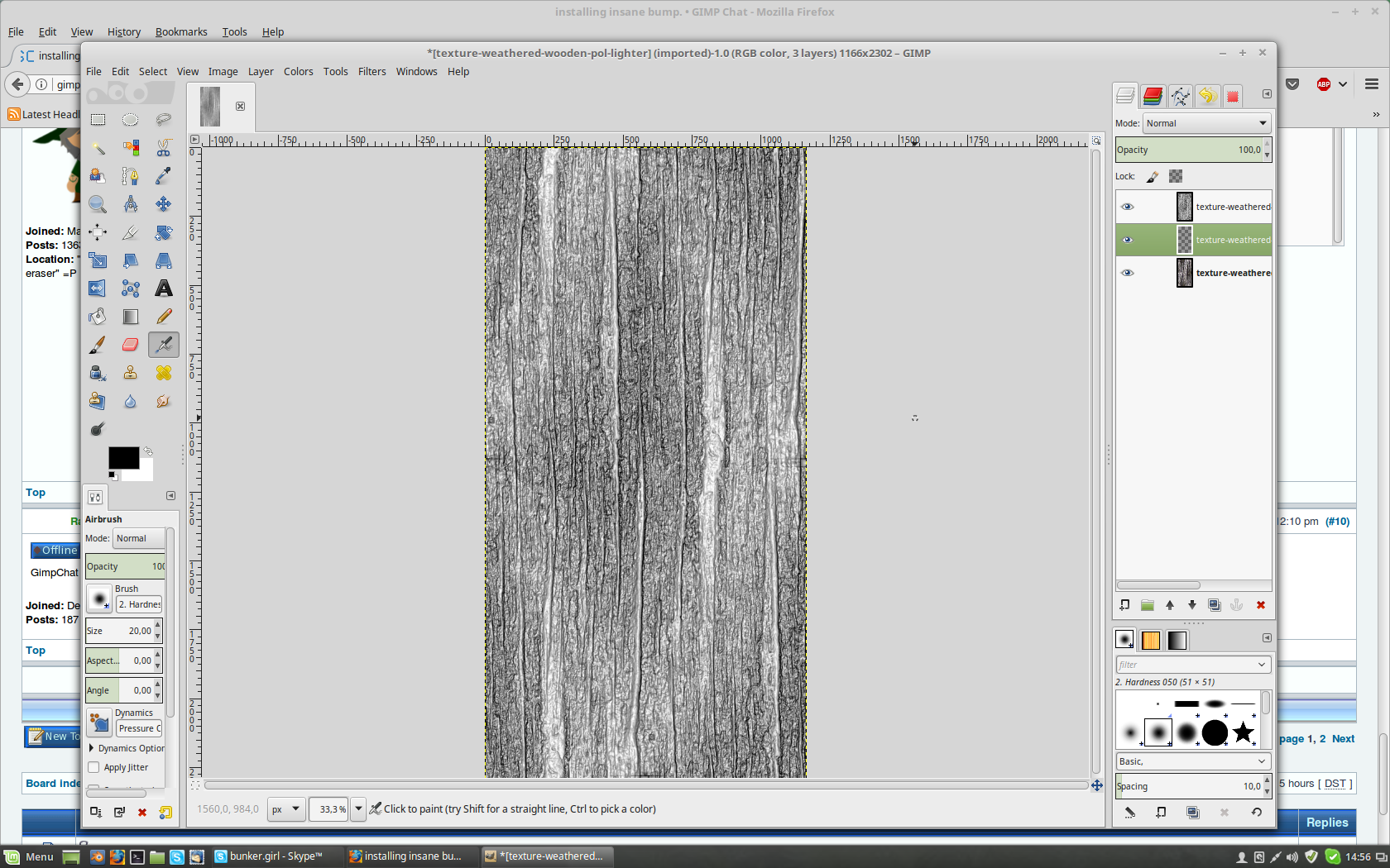

[quote="rich2005"]This is not going to be easy for a beginner. First what version of Mint and is it 32 bit or 64bit ?
Assuming 64 bit
Hallo Rich
ive finally installed my insane bump but get the same results as you
So the results that rod gets i dont get with the previews of the different maps.
Im also not getting all the maps. Im used in windows to getting 6 diffrent maps.
Id prefer that. How can i solve this?
