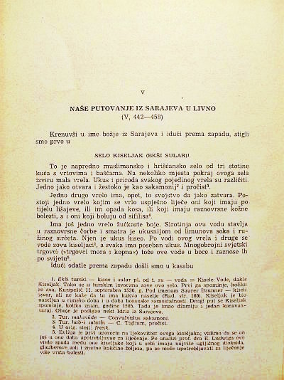

Yes, I have samples. It is just text without pictures. The gimpchat forum still does not allow me to share external links in my messages, as I am fresh new user, so I will try to trick it somehow. Be creative to make the URL's ;)
Original image: i . imgur . com / fOYOE6L.png
Processed image: i . imgur . com / nk6YrQo.png

Is this clear enough?
I got that , again, by using a G'MIC filter, this time 'Film Emulation > Negative [color]'. Maybe that? Of course you could try other combionations of settings and do like I said before (for All Images)

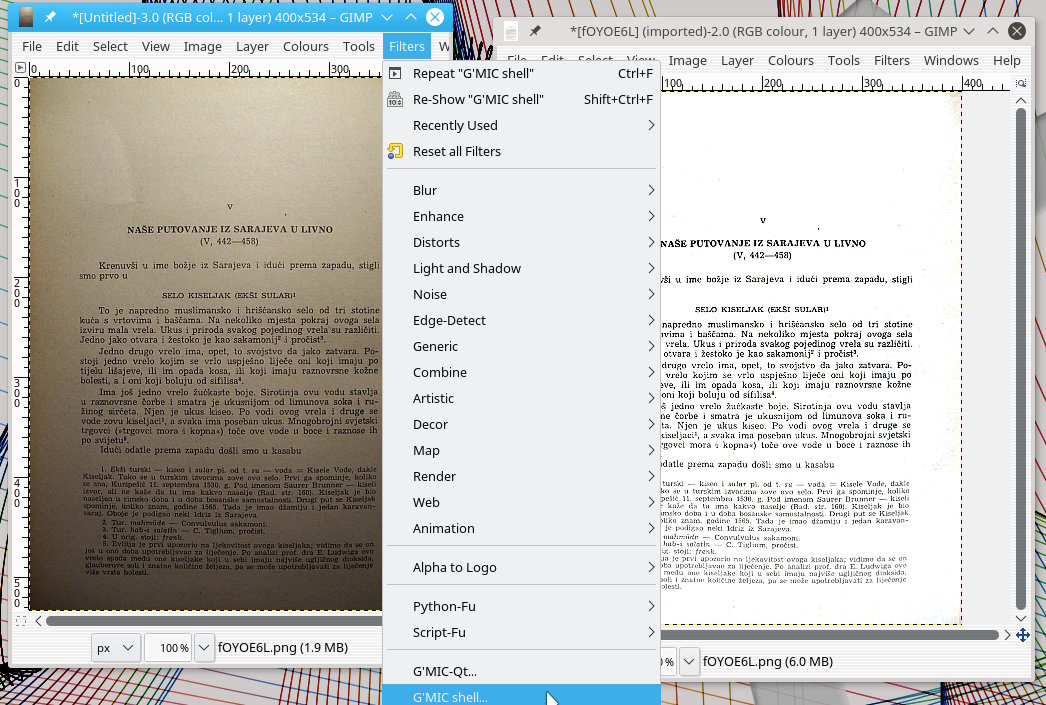

Huh, it will take some time to process this. Forget about ScanTailor, it is an application irrelevant for this topic. I'm using GIMP on Windows so I need to adjust some steps in your guide.
 Post subject: Re: Batch script for image brightness equalization?
PostPosted: Sun Nov 05, 2017 2:28 pm  (#15)
Posts: 2613
You are the one who mentioned scantailor...and also BIMP Just offering a possible solution.
..For that purpose I'm using ScanTailor program...
Attached a slightly tweaked script to suit your scan. Is that the best you can do? IMHO too small.
Anyway to check the script, You will need gmic intalled. Running on your example
For lots of images use it with BIMP as previous post.

Yes, I installed both, BIMP and G'MIC. Actually, I can run sequence of G'MIC filters on multiple images directly from BIMP, so I do not understand why do I need gmic_shell.scm?
Thanks for your help!
PostPosted: Sun Nov 05, 2017 6:21 pm  (#17)
Joined: Nov 04, 2017
Posts: 9
Well, I did it :jumpclap . Based on script sent by rich2005 I created my own solution that performs sequence of the algorithm from the beginning of this topic (duplicate layer/gaussian blur/invert color/desaturate color/layer mode overlay). G'MIC is not used so I changed the script name to my-img-shell. It is in the attachment.
For batch processing I used BIMP plugin and called my-img-shell script from it.
Thanks to all of you guys for your help!
