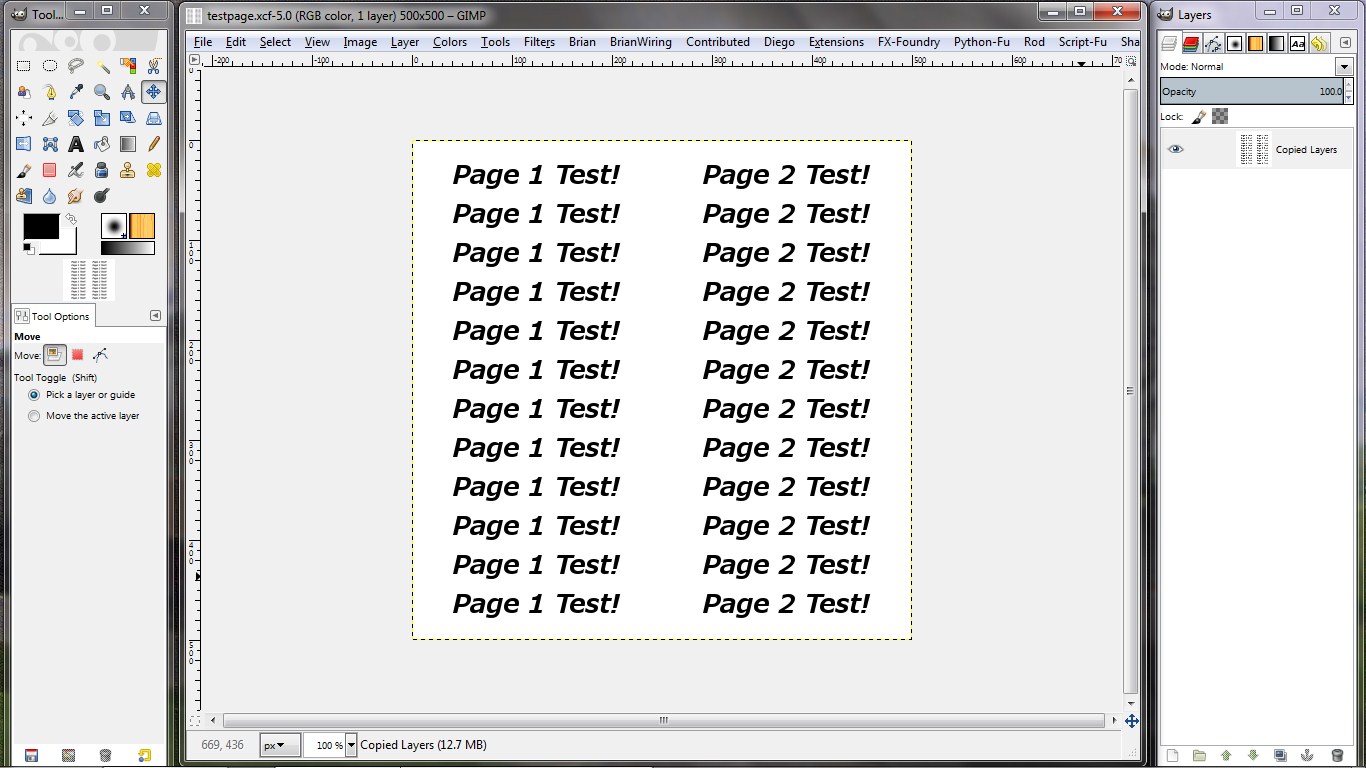

 Post subject: Re: I need an automation script to separate left and right pages
PostPosted: Mon Nov 20, 2017 11:29 am  (#10)
Joined: Jul 04, 2010
Posts: 2253
Here you'll see the result of the script:
Original Un-switched image
Switched image. Note the two layers in the layers list.
