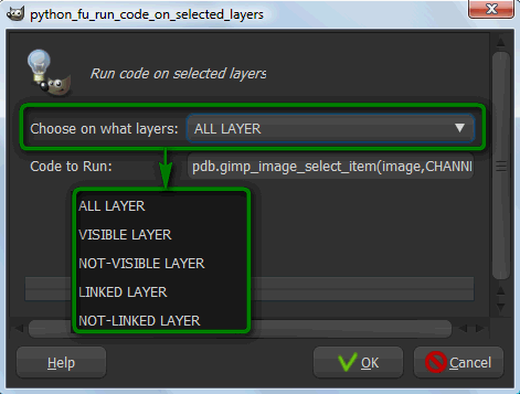

PostPosted: Wed Feb 28, 2018 12:07 pm  (#22)
Hi Tin.
The ability to separate (add) commands using a semicolon (;) is a great thing
Small addition: Choose on what layers.
ps.In the next version, I would like you to add support for the layer group :yes
Run_Code_On_Selected_Layers.zip [1.3 KiB]
Downloaded 94 times
 Post subject: Re: Run Code on Visible Layers Script for GIMP
PostPosted: Wed Feb 28, 2018 12:58 pm  (#23)
Posts: 4528
great idea MareroQ,
available in version 3 of script.
TinT
