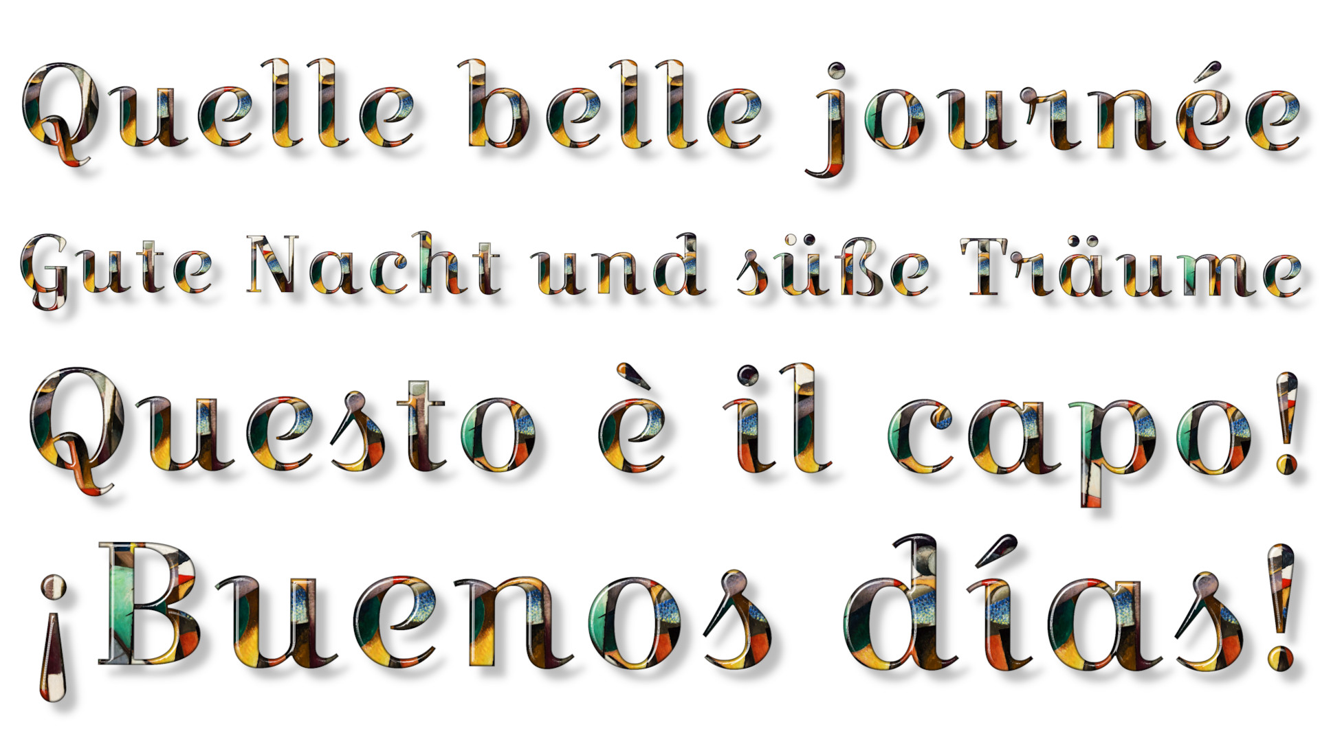

I have added options to convert at least some French/German/Italian/Spanish characters to Custom Font layers.
Obviously the characters must be present in the original font.
I have also taken the opportunity to prevent empty layers from being added as character layers.
