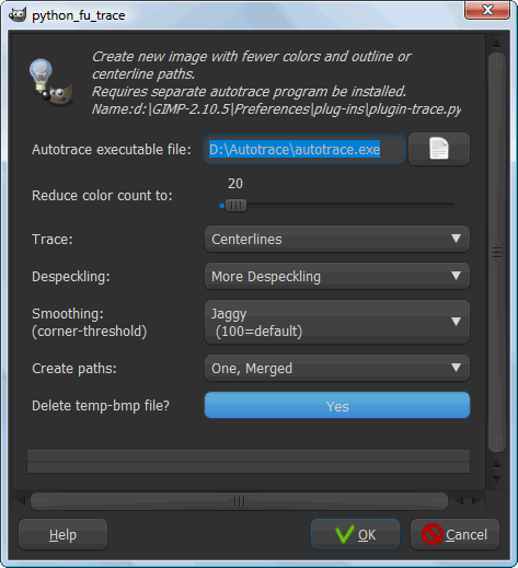

PostPosted: Thu Jun 06, 2019 10:47 am  (#1)
Autor: Lloyd Konneker (bootch nc.rr.com)
Data: 2009
In menu Gimp: Filters -> Edge-Detect -> Trace...
More interesting information can be found in the readme-plugin-trace.txt file
After reading a very interesting topic:
Paint Paths in Steps plug-in
http://gimpchat.com/viewtopic.php?f=9&t=17482
I remembered Plugin-trace.py - I've never managed to run it in Windows.
Now I know that this is due to the type of files supported by autotrace (it does not support png files - I do not know if this is a bug or a change in autotrace) and a few spaces...

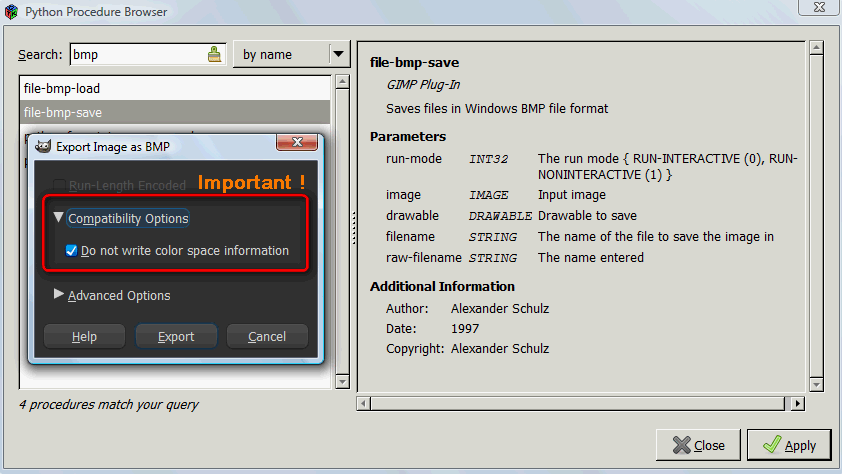

The temporary file is saved interactively - and important (the problem of autotrace or my older version of the 32bit file that supports Win Vista):
In Compatibility Options
Select Do not write color space information.

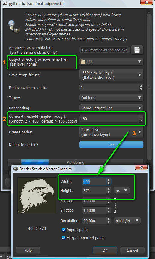

Ver 0.3
Some minor changes:
1.Add output directory to save temp file,
2.Replace "Smoothing" (PF_OPTION) to "Corner-threshold" (PF_SPINNER)
3.Changed descriptions...
plugin-trace-V 0.3.zip [9.29 KiB]
Downloaded 297 times

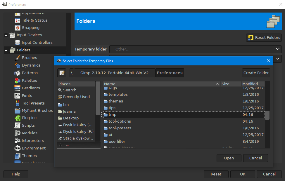

For the purposes of the test:
- in Edit -> Preferences -> Folders, change the default location of the temporary folder to a suitable one for portable:
i.e. for example d:\Gimp-2.10.12_Portable-64bit-Win-V2\Preferences\tmp\
- Gimp restart
- use Trace (Delete temp-file? No, Create paths: One, Merged) twice with the option:
1. Save layer to a temp-file as: BMP
2. Save layer to a temp-file as: PPM
Check the Preferences/tmp directory and let me know what gimp-temp files have been created?
