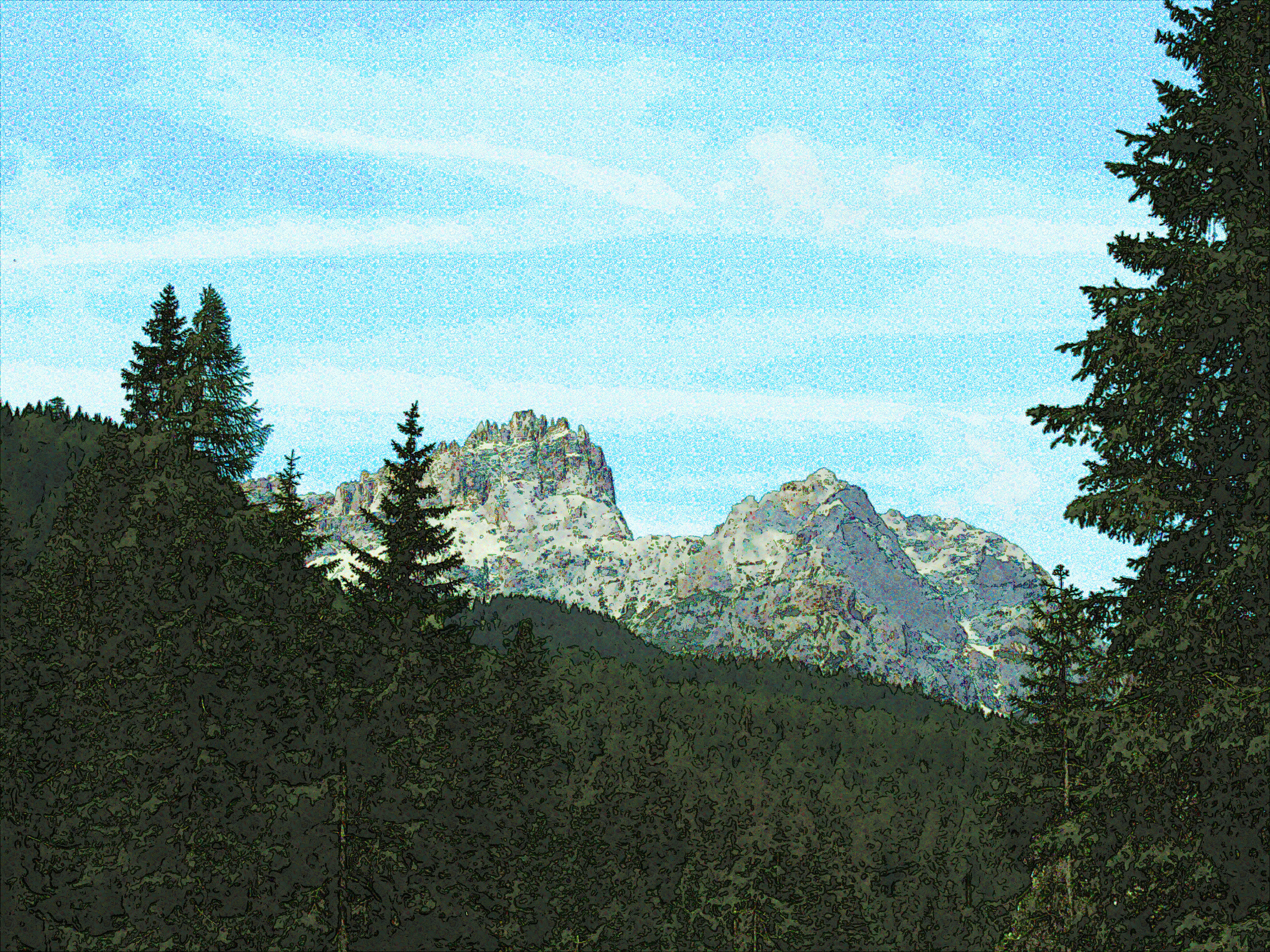

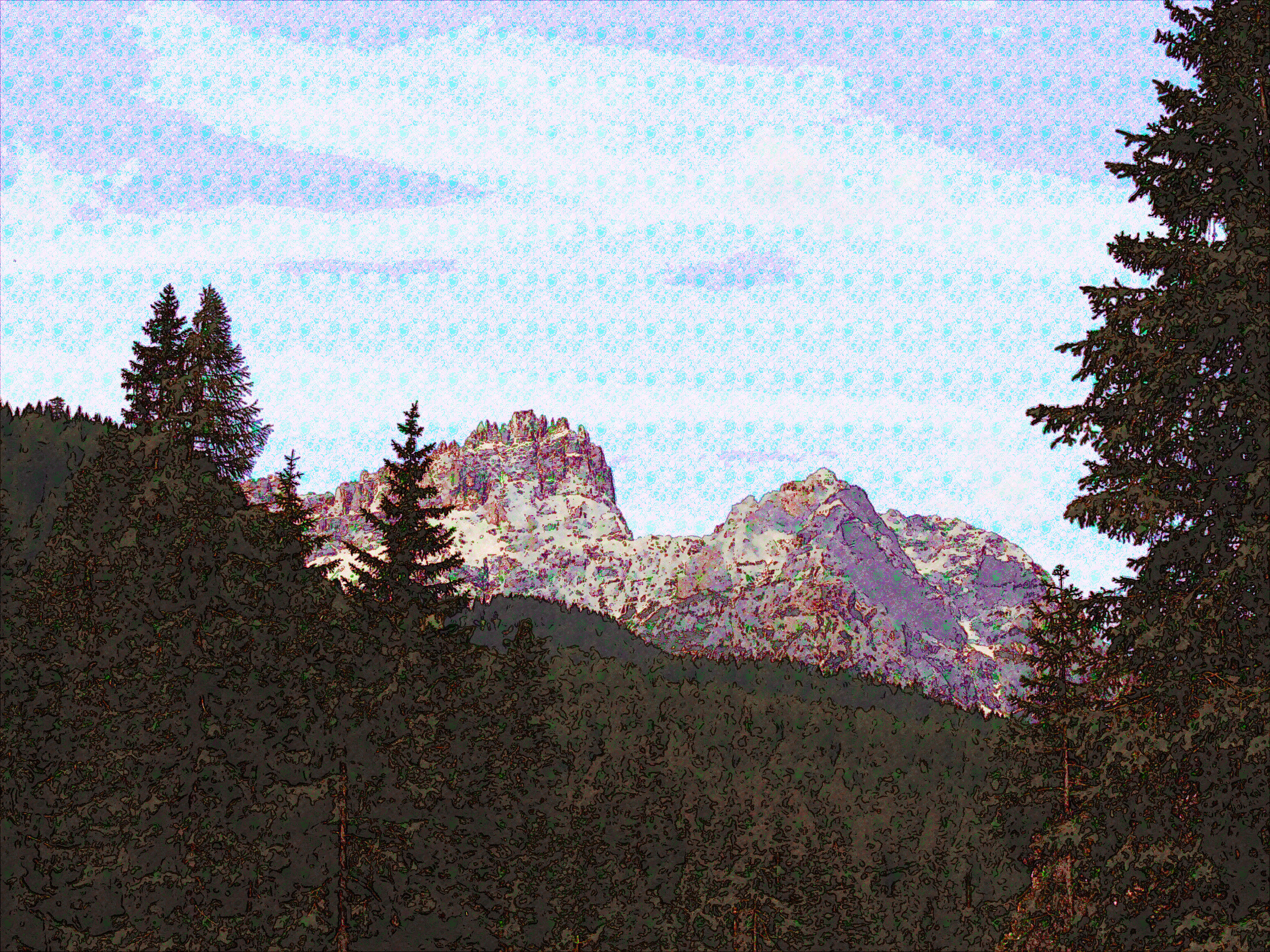

Did a couple of tests:
1-using Mandelbulb-225
2-using Mandelbulb-231
Results are visibly different.
All other parameters left to default.
Filter used:
DIEGO_ARTISTIC_MultiColouredParticles.7z [3.93 KiB]
Downloaded 166 times

BTW:
This is the output leaving all defaults (that is: Mandel, the filter will select the colours from tha gradients having Mandel string in the name).

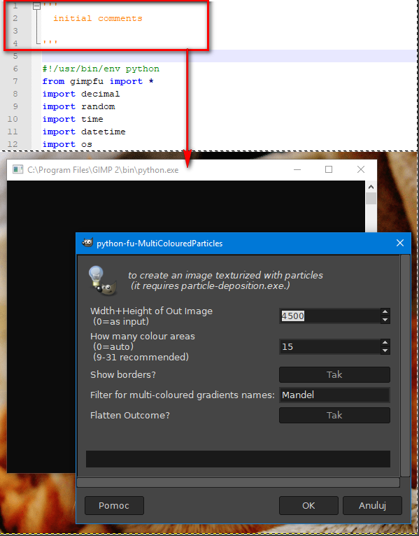

Dinasset,
is this supposed to happen when calling up MultiColouredParticles?
I downloaded the one you attached to your post. I'm using GIMP 2.10.12 windows 64 bit. I downloaded GIMP from gimp.org.
 Post subject: Re: small ancillary filters (33, index on first post)
PostPosted: Mon Sep 02, 2019 12:45 am  (#767)
Not at all.
But I'm using Samj's 2.10.12 64bits.
Maybe conflict with the "particle-deposition" exe filter used?
This is the one I have and use:
particle-deposition.7z [8.47 KiB]
Downloaded 140 times

I can repeat the problem of an additional python window in Gimp 2.10.12 64bit (from gimp.org) - when the plugin does not start with:
#!/usr/bin/env python
After a small correction - the console window does not appear.
Interesting that this is not a problem in the Portable Samj version.

Thanks MareroQ.
Removed initial empty comment.
DIEGO_ARTISTIC_MultiColouredParticles.7z [3.91 KiB]
Downloaded 158 times

dinasset, for what it's worth going forward, on Windows 10 64-bit using python scripts, one only needs to add #!/usr/bin/env python as the first line.
Neither the ' ' ' comments ' ' ' below that line nor the original initialization string "#!/usr/bin/env python" below the comments need to be deleted for the plugin to work.
