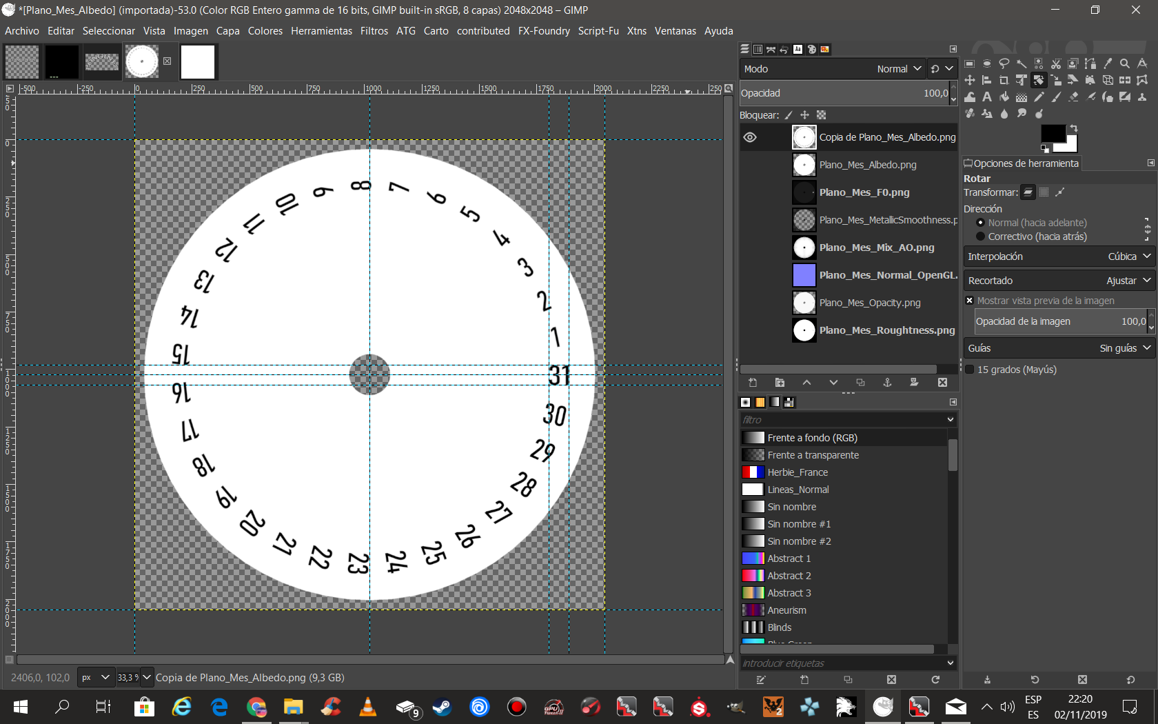

Well I would like someone to help me, me and anyone who may need it, I have been making a 3D model of a watch, and I have found myself in the need to create the calendar dial, with 31 days.
All good, until I have realized that I have been doing this madness for hours and hours.
And I thought, damn it, with a "Scrip" you could expedite this torture.
It would be faster more efficient, and it wouldn't hurt my head.
If anyone is interested in writing a "Script", and lend me a hand :), I am willing to help in any way I can.
(I enclose an image of what I have done!)
Thank you very much to all.

Have you tried the "Text to Circle" script? File>Create> Logos> Text Circle ?
Or you can create a circular path and place the text on the path.

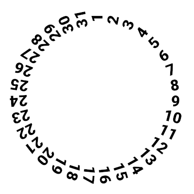

My take; make a vertical column of numbers, rotate left, then run Pan to Bow script-fu. Pretty simple. :)
edit:
As a sidenote, I should have center all the text to get a result similar to Offnuts. :)
