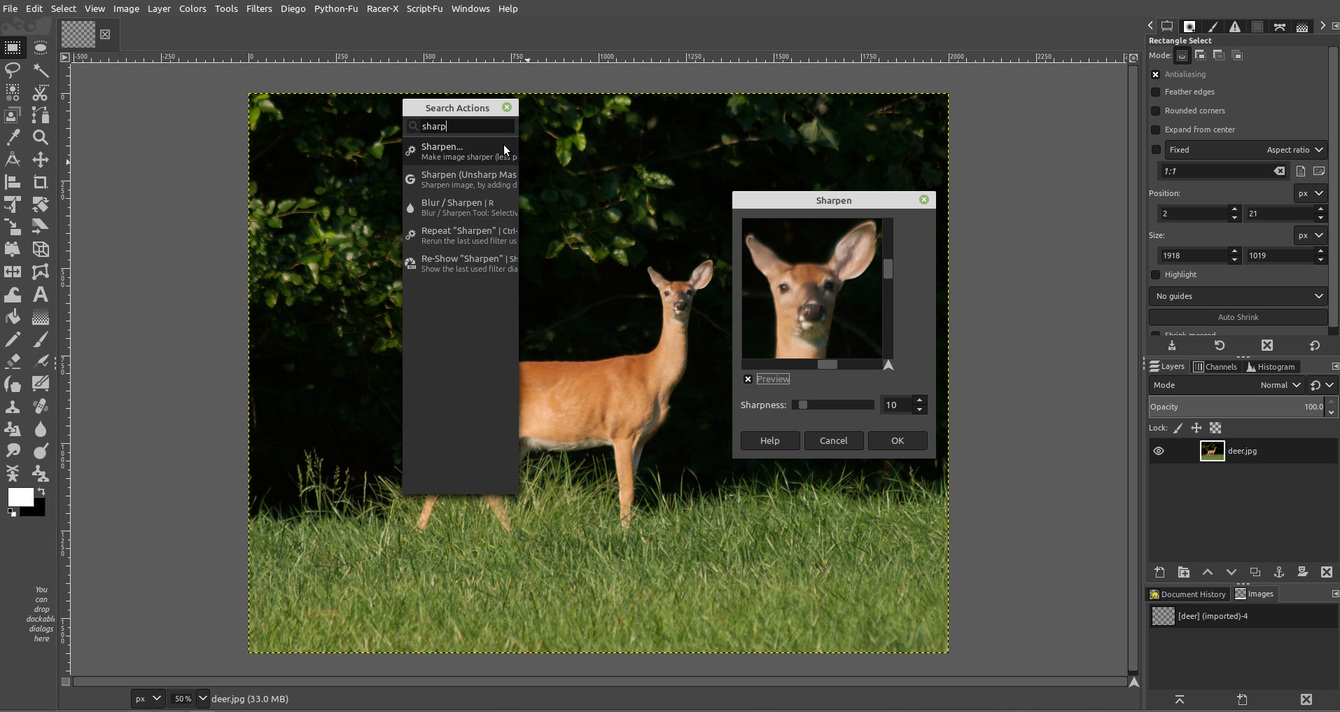

There is no need to bring over the old sharpen filter, it's already included in Gimp 2.10x. Just search for it using the "/" key on your key-board.
