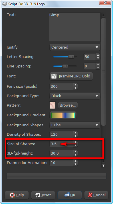

The scripts (Gimp 2.8.14 GMIC 1.6.0.0) does not accept decimal places.
Size of Shapes = 3 (OK)
[gmic_gimp]./apply/ -v - -gimp_random3d 0,120,3.0,100,45,0,0,-100,0.5,0.7,5,1
Size of Shapes = 3.5 (ERROR)
[gmic_gimp]./apply/ -v - -gimp_random3d 0,120,3,5.0,100,45,0,0,-100,0.5,0.7,5,1
Solution - only integers - or:
this code:
  SF-ADJUSTMENT "Size of Shapes" '(3.5 1 20 0.1 1 1 1)
  SF-ADJUSTMENT "3D-fgd-height" '(30 1 50 0.1 1 1 1)
change to:
  SF-ADJUSTMENT "Size of Shapes" '(3 1 20 1 1 1 1)
  SF-ADJUSTMENT "3D-fgd-height" '(30 1 50 1 1 1 1)

Carlos Diniz I just checked the download on the initial post and it runs fine on 2.8.10 and 2.8.14 are you sure you are using the latest release 3 I don't think there is any reason to change the script as I do not know what errors or problems you have, you only said it doesn't go (not much help really)

Graechan, I now have GIMP 2.8.14 and the latest version of 3D Fun script. When I run the script I keep getting the same error messages as described in # 83. Nothing has changed.

This script works fine for me using gimp-2.8.14.

Posts: 590
MareroQ, you're right. I made the changes proposed and I managed to get the expected result. Thanks very much.Image

I would not recommend any one else making the changes MareoQ suggested as they are unnecessary for the script to run
