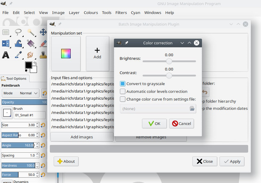

The easiest way for a large number of images is use an existing plug-in BIMP see: https://alessandrofrancesconi.it/projects/bimp/ where you can add various procedures including a convert to grayscale.
Edit: This issue came up one time. Using BIMP and png format an alpha channel is added. No way to avoid this with BIMP as the export is the final function.
