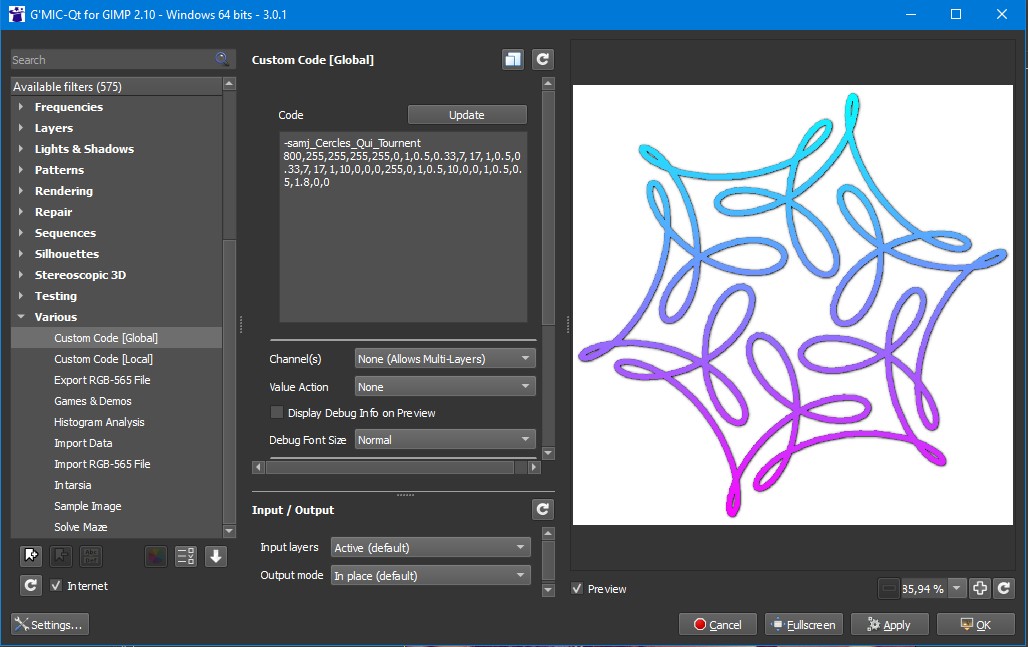

These filters are still in the latest version.
One only changed the name (from French to 'required' English)
From this:
Testing > Samj > Rendering > Cercles_Qui_Tournent
on this one:
Testing > Samj > Rendering > Rotating Circles
The presets on the pages You provided are almost 8 years old - since then, the syntax and the number of parameters have changed.
You can test the preset by comparing (pasted in the Custom Code with the copied current setting).
For example, one parameter came for samj_Cercles_Qui_Tournent:
-samj_Cercles_Qui_Tournent 800,0,0,0,255,0,1,0.5,0.33,7,17,1,0.5,0.33,11,17,0,4886,255,192,0,255,0,0,0,0,0,0,0,0.5,0.5,1.8,0,0
-samj_Cercles_Qui_Tournent 800,0,0,0,255,0,1,0.5,0.33,7,17,1,0.5,0.33,7,3,0,4520,255,192,255,255,0,0,0,0,0,0,0,0.5,0.5,1.8,0,0
-samj_Cercles_Qui_Tournent 800,0,0,0,255,0,1,0.5,0.25,1,6,0.8,0.2,1,9,12,0,493,255,192,255,255,0,0,0,0,0,0,0,0.5,0.5,1.8,0,0
-samj_Cercles_Qui_Tournent 800,255,255,255,255,0,1,0.5,0.33,7,17,1,0.5,0.33,7,17,1,10,0,0,0,255,0,1,0.5,10,0,0,1,0.5,0.5,1.8,0,0
-samj_Cercles_Qui_Tournent 800,0,0,0,255,0,1,5,2,3,10,1,0.5,0.33,7,17,1,4693,0,0,0,255,0,1,0,0,0,0,1,0.5,0.5,1.8,0,0
-samj_Cercles_Qui_Tournent 800,255,255,255,255,0,1,0.5,0.25,7,21,1,0.5,0.33,7,17,1,1000,0,0,0,255,0,0,0,0,0,0,0,0.5,0.5,1.8,0,0
I leave the fun with Chrysodes for You. :mrgreen: :yes
