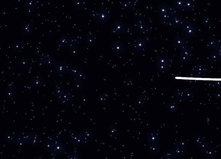

Cool idea with spyrogimp. I call this Lost In Space.
