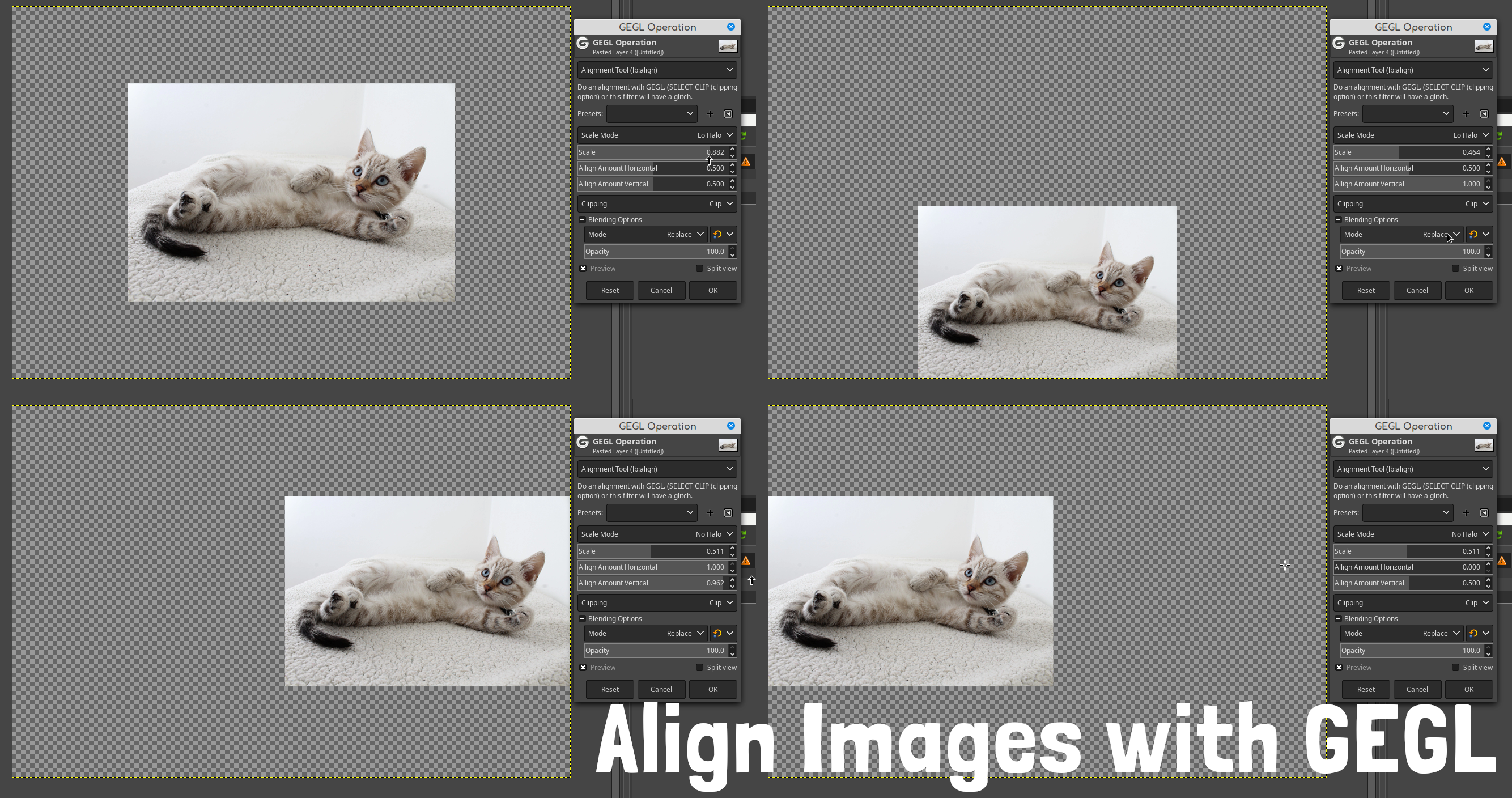

This new plugin is a GEGL based alignment tool that is an alternative to Gimp's alignment tool in a sense. But it only works on full size images and has an unsolvable bug that can only be solved by the user once or twice per use session switching the clipping option setting back and forth to remove the glitch it.
0.0 is left
0.5 is center
1.0 is right
The scaling options are nohalo and lohalo (the best scaling algorithms)
Video preview of the plugin in action
https://streamable.com/t1f0i2
Image Preview of different alignments. This is my 70th GEGL plugin BTW. REMEBER TO SWITCH THE CLIPPING OPTIONS WHEN THE GLITCH APPEARS (IT WILL) Enjoy!
LOCATION TO PUT BINARIES
Windows
Linux
/home/(USERNAME)/.local/share/gegl-0.4/plug-ins
Linux (Flatpak includes Chromebook)
/home/(USERNAME)/.var/app/org.gimp.GIMP/data/gegl-0.4/plug-ins

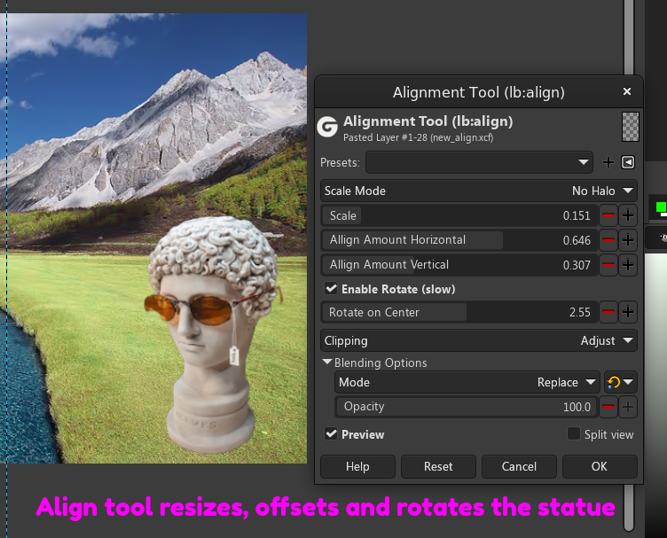

Non-destructive basic transformations in GIMP 2.99.19
As we all know GIMP 2.99.19 does not allow non-destructive gradients and non-destructive transformations. So I modified an existing plugin of mine to do that in a hacky way. Align tool is going to update soon with the ability to work like a scale and rotate tool in GIMP 2.99.19. Allowing basic non-destructive transformations
This image of the statue is so large that only a small part of it fits on the canvas.
Align tool with its update to allow non-full size images and rotations applies basic scale, offset and resize abilities

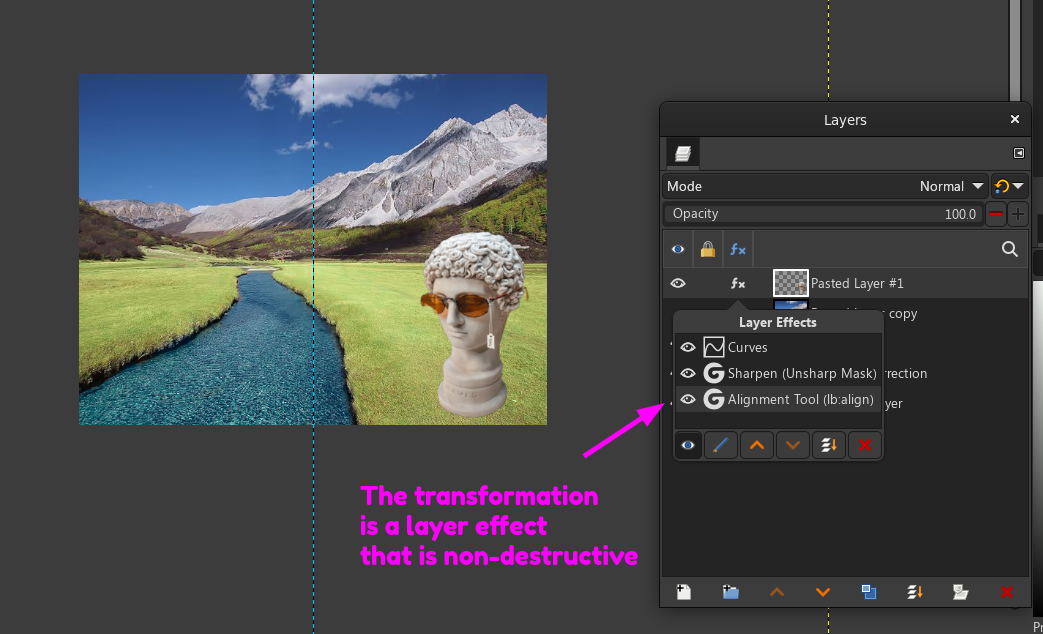

Now the non-destructive transformation is a layer effect
