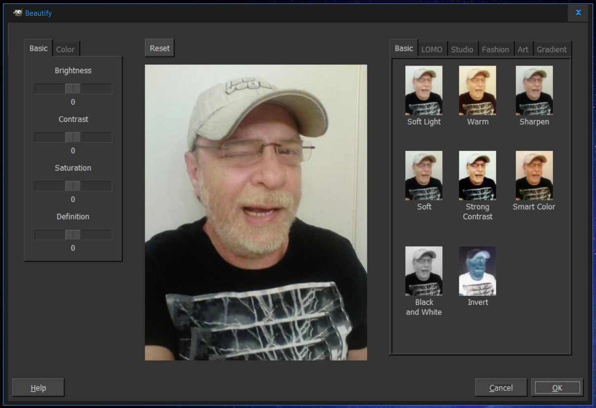

2-ton wrote:
Are there two beautify filters. I could swear I had one that had pages and pages of filters but now all I have is one that makes text or logo shiny??? Maybe they have moved it or my last update of mcgimp didn't have it.
As far as I know there's only one and it's a plugin.
Is this what you're referring to...
Please forgive my selfie. :oops:
If you find the need to avert your eyes or look away, please feel free to do so.

YEs, Wallace, that is the one I was looking for. I know I used to have it, and now this is what I get...
