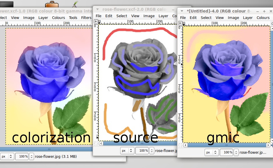

Gmic Black & White -> Colorize[photographs] is very similar to the colorization plugin
comparison:
all in Mint 17 32 bit, Gimp 2.9.3, G'mic for 2.9

thanks Rich.
At a first test, it seems that the result of G'MIC is more "crude" and approximate, not to be taken as such, needs some "interactive" try-and-see
