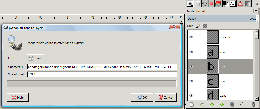

Hi Tin Tran.
Your idea is better than PhotoFont. :yes
To facilitate the design: of small plugin (Filters-> Text-> Font to layers ...)
Font-to-layers.zip [2.14 KiB]
Downloaded 806 times

MareroQ wrote:
Hi Tin Tran.
The idea is however spawned from PhotoFont :hehe
Great job on facilitating the design. :hi5
but i just tried it and i don't know why i am getting this when i try to run it on a new image
GIMP Error
Calling error for procedure 'gimp-floating-sel-anchor':
Procedure 'gimp-floating-sel-anchor' has been called with an invalid ID for argument 'floating-sel'. Most likely a plug-in is trying to work on a layer that doesn't exist any longer.
Your tool looks great because then i don't have define custom symbols at all, it'll just work because I tried naming my layer as "?.png" and it lets me so if we use your tool we won't be restricted by external filenames
i might have to delete my if check that looks for "space.png" when it finds a space in my script because with your tool it'll just look for " .png" which should work just fine.
TinT

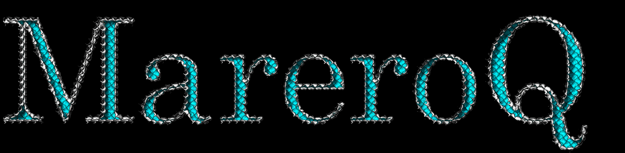

Not as nice as Rich- but fast (with GMIC).
