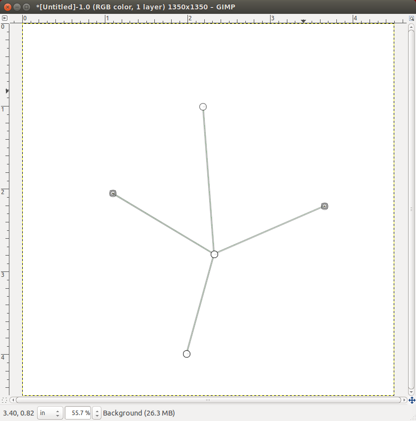

I have an idea that it might be approached by processing a closed path off-line.
Here are a couple of figures: of the original, simple path [Edit: created with Path tool], and of the enclosing path created with Save-Selection-As-Path [Edit: after stroking the first path with a 1-pixel brush and selecting that].
From staring at these and my real problem, it occurred to me--and probably laughably obvious to everyone else--that nodes "close" to each other should be replaced by their average to simplify the representation.

The first image was of an open path concocted with the Path tool (by drawing 4 paths actually and combining visual paths into one
I stroked that path with a 1-pixel brush (and failed to mention it).
Then I selected-by-color what was stroked and the second image shows the closed path created by GIMP (2.8).
I would like to be able to get an open path, either from "Selection-To-Path" tool directly or by processing the closed path that results from that.
Hope that's clearer. [because I have also made edits...]

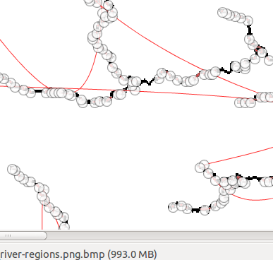

I can, at least, "reduce" the closed path of Bezier curves to a path of line segments. I exported the closed path with Ofnuts' fine path to/from CSV plugin, for the simple path, and for one with a Bezier node added to one leg.
I loaded them both into openoffice Calc and discovered the 1st and last pairs of columns held coordinates of the control points (and just now discovered the same information in ofnuts' plugin :oops: NB. to newbies: Did you know you can READ the scripts with a text editor?)
I copied the central pair of columns overtop of the control columns, wiping out curvature information and used the plugin again to load
the edited CSV back into the project.
I am currently drowning in Molasses Swamp trying to see if I can find "similar" nodes, and replace them with their averages, inside
a spreadsheet. Almost certainly the wrong tool, but from what I skimmed about Markov and random-walk, I'm not eager to exchange
a Swamp for Black Hole.

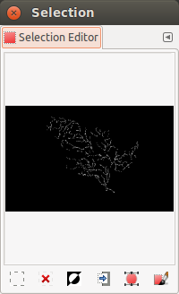

NO! I was not aware of it, although I do recall seeing some of the items on the settings menu: I've been racking my brain but cannot recall where.
I did find that the "Selection Editor" on the Select pulldown menu has a "Selection-to-path" icon and which hints "Shift Advanced Options" when hovered over.
I'll have to puzzle through the selections to see if there's a way to force an open path.
Thank you for some hope.

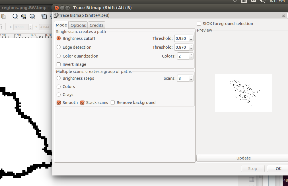

I did look at Inkscape, and it's advice that "Trace Bitmap" uses Potrace ultimately led me to find autotrace (which traces centerlines, unlike the former), but all I can report is that no obvious "Way How to Proceed" revealed itself, and ultimately I just kept wandering around lost in the woods, looking under rocks. Inkscape's reminder of Potrace's reminder of autotrace at least reminded me that THAT is where I saw arguments similar to what are in the Selection Editor's menu's Advance Settings.
Still Inkscape shows promise in that its Path->Simplify routine DOES seem to reduce the number of nodes. However, at the same time, it also adds wild curvature (possibly because it imagines the curves pass through removed points...). The result is a rather a modern artist's impression of what a river system _should_ looks like. No doubt this is due to my choices for Tracing and my choice of threshold for Simplifying, but there are no obvious guides for the un-mathed.
I did use my trick of importing the new simplified Inkscape path into GIMP, then exporting it with ofnuts to-CSV, then over-copying the Bezier control points in openoffice with the endpoints and importing the edited CSV back into GIMP. That removed all the curvature, but revealed that in the process of simplification, Inkscape left behind a horde of orphaned nodes--degenerate paths.
So, Inkscape is a "possible" but it would take someone with insight to guide the processes to the desired result I think.

File comment: Path->TraceBitmapSettings to get a path in the first place. (Wonder now what if I didn't simplify it? For one thing, GIMP would have an even harder time swallowing all the extra nodes.)

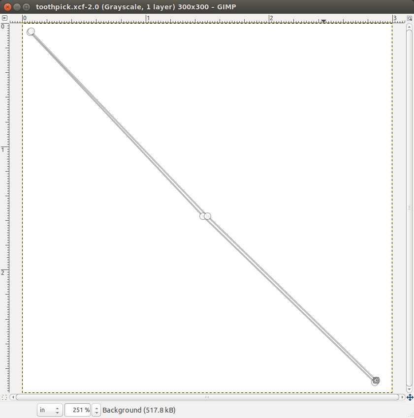

Here's a GIMP project containing only a simple, open, path to test Inkscape's algorithm. (It can be closed and tried too.)
I want to replace the closed [sorry, open in this picture] path representing a putative invisible open path with an open path representing the putative center-line of the closed path.
[Edit: I can see that the obvious thing is to replace each pair of close nodes by their average locations.]
toothpick.zip [1.15 KiB]
Downloaded 92 times

BTW, I should add that another problem with Inkscape Path->Simplify is that nodes that were close are often replaced by nodes that are not...
...so, when this is finally possible [Future? Saaa-LUTE!], it will behoove us to render the open path first and then simplify that.
