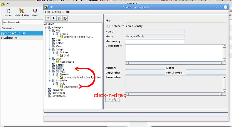

Then for changing script-fu menu locations without manually editing each script.
see: viewtopic.php?f=4&t=6028
A java application JGIMPOS. Drag-n-drop from one menu to another. It does make a back up of the script but not something I use, so up to you to try out.

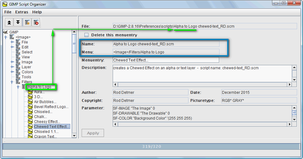

Just a suggestion:
For my comfort: I add to the file name - its location in the menu.
GSO is important for the name and location - but the changes editing in notepad ++

Rich2005, thank you! That is exactly what I am looking for. I even created a launcher on my lower taskbar so I can fire it up whenever I feel the need.
MareroQ, that is a pretty good idea. Do you just rename the scm file in the folder? Or do you change something else?

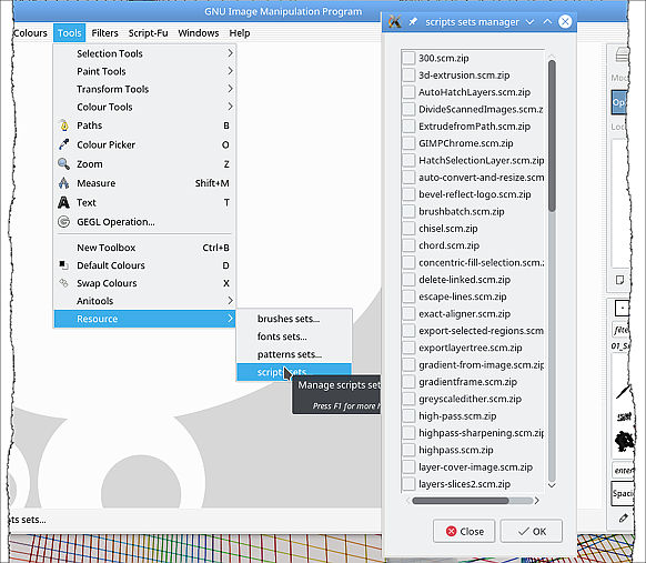

Thanks for posting the video, good information. On the Tools Menu how did you get the Tools>Resource>Scripts Sets Manager showing all of the sets?
Larry

Caution! before using GSO make sure you copy all your scripts in case corrupts the ones you try to shift
Below is what it did to one of my scriptswhen I tested

@ Rich
Larry

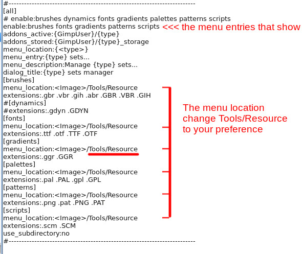

AddonCollectionManager: Make sure everything works with the default setup first.
Want to customise the menu locations?
It is described in http://gimp-tools.sourceforge.net/managementtools.shtml
Create an .ini file addonCollectionManager.ini to go alongside addonCollectionManager.py in .gimp-2.8\plug-ins folder.
It might look like this
If you need to do any text editing in Windows then do not use 'Write'. 'Notepad' is dire, so get one of the free text editors such as notepad++
you can try this example:
addonCollectionManager.ini.zip [551 Bytes]
Downloaded 115 times
remember to unzip it.
Does it work with Win10 and Gimp 2.8.18? Being a linux user I thought I better give it a try.
In a Win10 64 bit VM. screenshot. http://imgur.com/VwYot61

The manager works perfectly, thank you very much for your time. I didn't realize how much stuff I've accumulated over the years. I should get done sorting and tossing by New Year's! :mrgreen: Have a great rest of the week.
