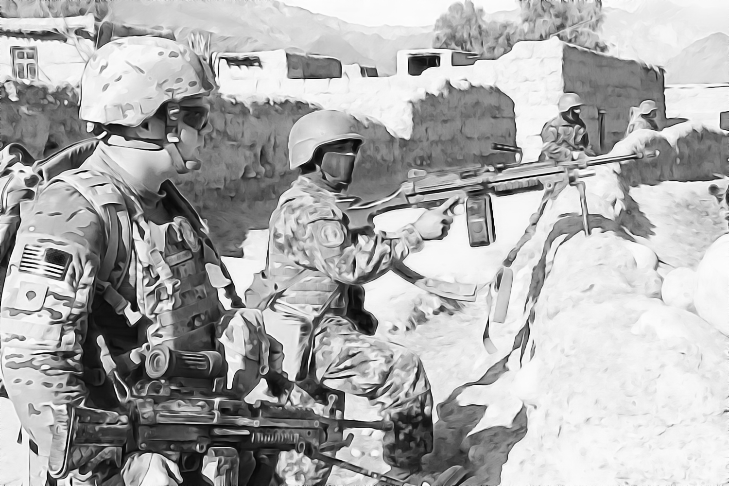

PostPosted: Tue Apr 05, 2011 2:08 pm  (#9)
I like, I like! Very much.
Original image here. I used unsharp mask on it because it was a bit blurry.
I set the inkwash layer to Value mode. I like the delicate, watercolor look to it.
