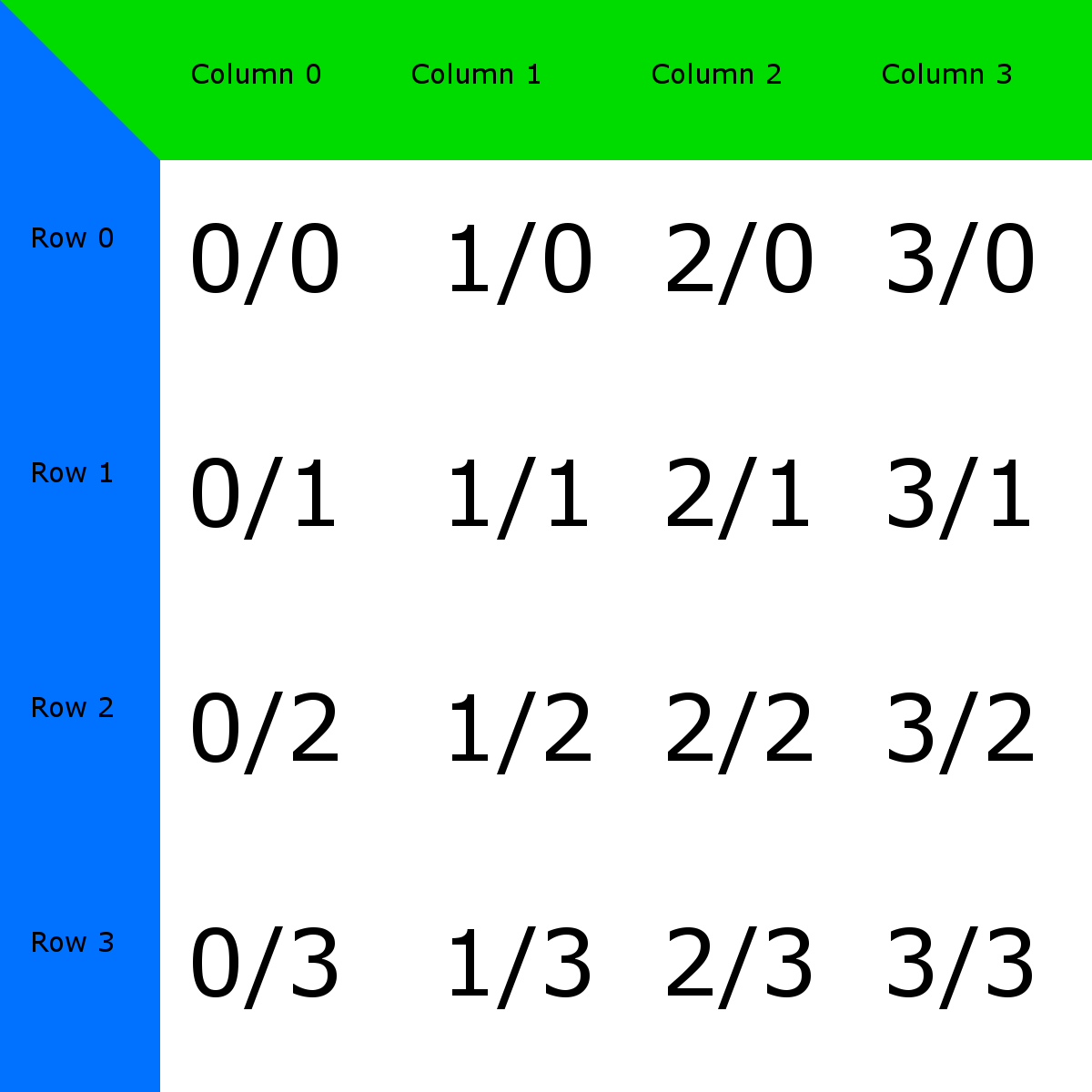

I have a "Map" of a game, divided into many pieces, and I would like to know, if there any tool or plugin, to rejoin the whole map.
(Too many images, to do it manually).
All parts of the "Map" are numbered:
The first number is the "Column", and the second number is the "Row"
I attached an image to see if it helps me explain.
Thank you very much to all, greetings
File comment: Example image

I really want to try it with this map!
 Post subject: Re: Tool, to join a "Map", divided into many parts?
PostPosted: Wed Apr 19, 2017 9:21 am  (#17)
Joined: Jun 22, 2010
Posts: 1171
Location: Here and there
OK here's my badly written Python plug-in
I don't know what will happen with your 32x32 tiles, good luck ;)
It doesn't save the resulting image when it is finished, so it is your problem to do so.
Extract the .py file from the zip archive and put it into your personal plug-ins directory.
It registers into the menus at contributed>>Build Map from tiles
build_map.zip [1.25 KiB]
Downloaded 93 times
PostPosted: Wed Apr 19, 2017 10:59 am  (#18)
Joined: Apr 17, 2017
Posts: 19
Hello paynekj!
I've tried the "Plugin", and I'm getting this:
An error ocurred running Python_fu_kp24_build_mad
- ValueError: invalid literal for int () with base 10: ''
More Information:
   File "C: \ Program Files \ GIMP 2 \ 32 \ lib \ gimp \ 2.0 \ python \ gimpfu.py", line 736, in response
     Dialog.res = run_script (params)
   File "C: \ Program Files \ GIMP 2 \ 32 \ lib \ gimp \ 2.0 \ python \ gimpfu.py", line 361, in run_script
     Return apply (function, params)
   File "C: \ Program Files \ GIMP 2 \ lib \ gimp \ 2.0 \ plugins \ build_map.py", line 24, in build_map
     Col_num = int (column_row [0])
I really do not know what happened :(
PostPosted: Wed Apr 19, 2017 11:10 am  (#19)
Posts: 1171
I can get that error if I have a file named: Map_Terrain_x.png (or Map_Terrain_axb.png) which is missing the row/column numbers.
You must ensure you only have files that include numerical row/column numbers
PostPosted: Wed Apr 19, 2017 11:43 am  (#20)
Joined: Jan 06, 2017
Posts: 204
Well, I can happily tell you it seems to work just fine, although I only used 90 x 90 px blocks of colour - the plug-in did it's job and arranged them properly (and pretty quickly too!)
Well done that man :)
Here is what the folder of original tiles looked like followed by the resulting image.
