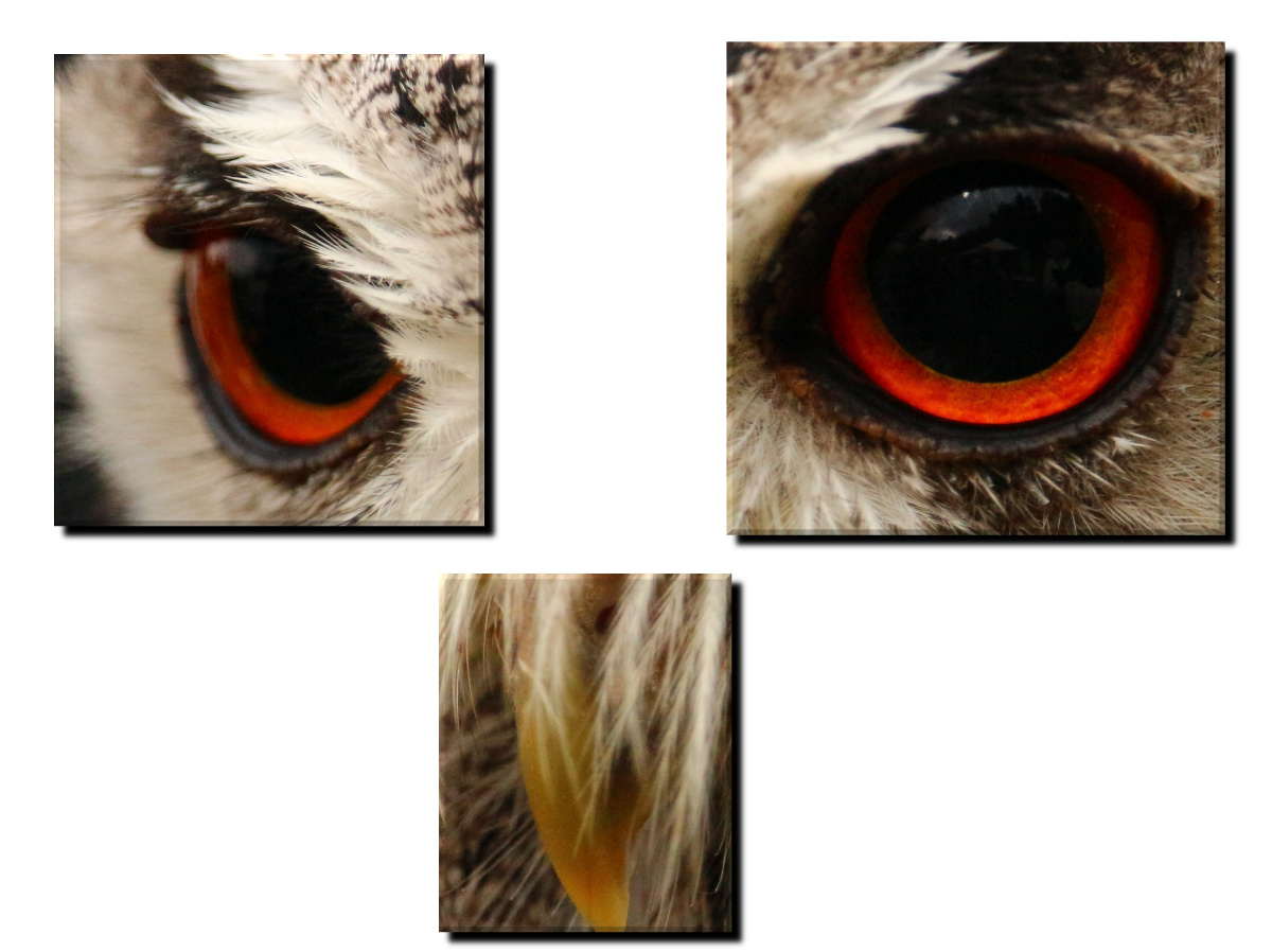

Just make your selection(s).
Then run script and you'll get something like below.

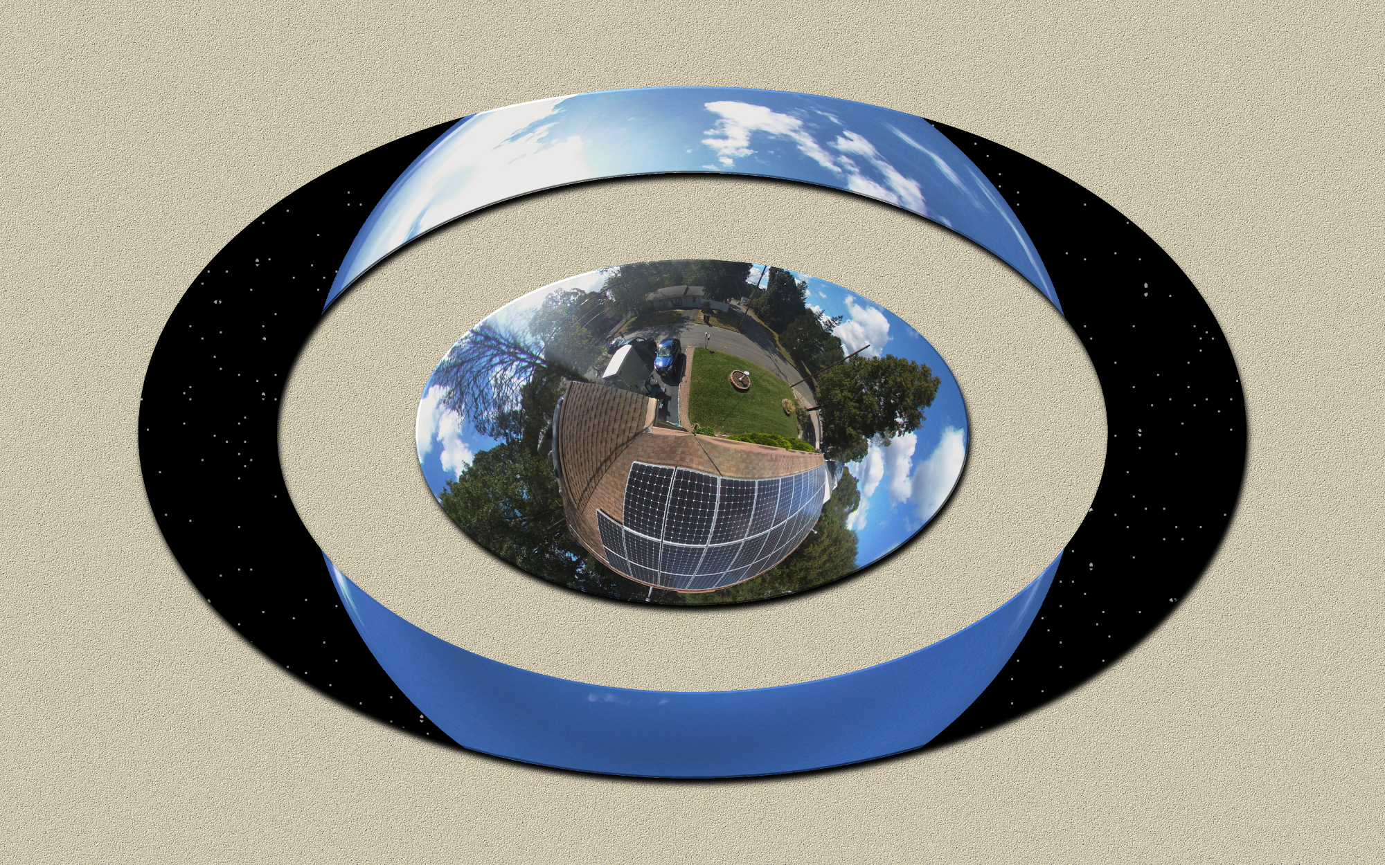

Thank You for a great script!

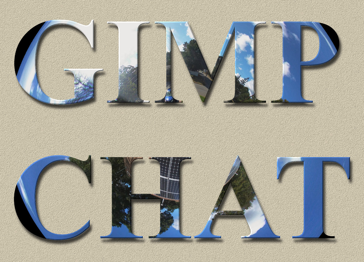

Yes, Thank You Wallace!

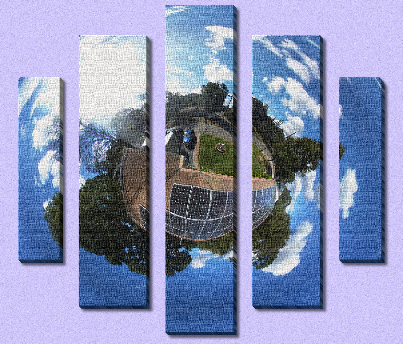

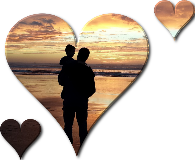

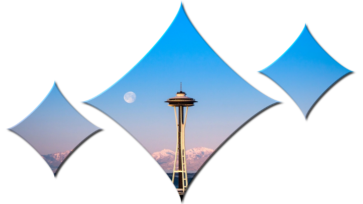

Posts: 2253
One thing that I noticed that is different between the script and Wallace's technique is that with the script the space between panels is dropped. With Wallace's technique there is no lost space between the panels.
If you were to slide all of the panels together, the edges would line up with Wallace's technique. They wouldn't with the script.
