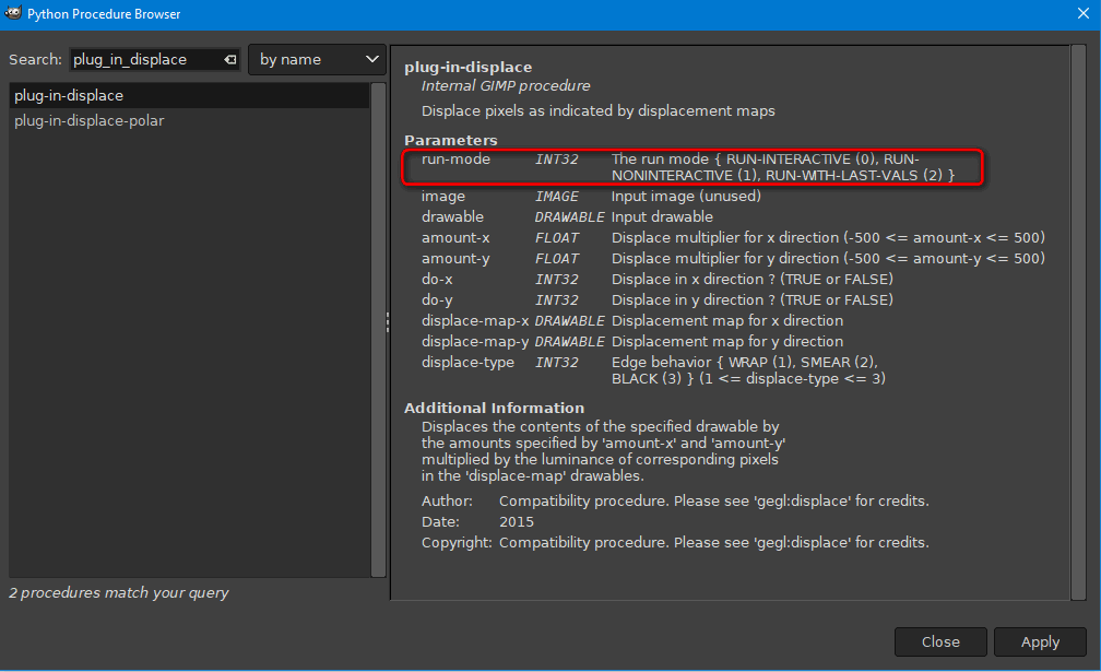

Hi i-regular.
You used the wrong number of parameters - lack: run_mode=......
pdb.plug_in_displace(img, tattoo_layer, 10, 10, True, True, disp_drawable, disp_drawable, 2, run_mode=RUN_NONINTERACTIVE)

MareroQ wrote:
Hi i-regular.
You never *need* that run_mode parameter. It's a named parameter because it is optional in the Python API (and defaults to RUN_NONINTERACTIVE, so you typically only use it with RUN_INTERACTIVE). The doc mentions it because the Python doc is built from the Scheme one, but there are mappings between the Python and Scheme.
 Post subject: Re: Help with pdb.plug_in_displace when using python-fu
PostPosted: Tue Feb 25, 2020 10:07 am  (#5)
... the Python doc is built from the Scheme one, but there are mappings between the Python and Scheme
This is what I understand now why in script-fu this is the first parameter and in python the last - if needed (because erroneously indicated in the Python Procedure Browser also as the first by stupid analogy).
Thanks for the clarification.
