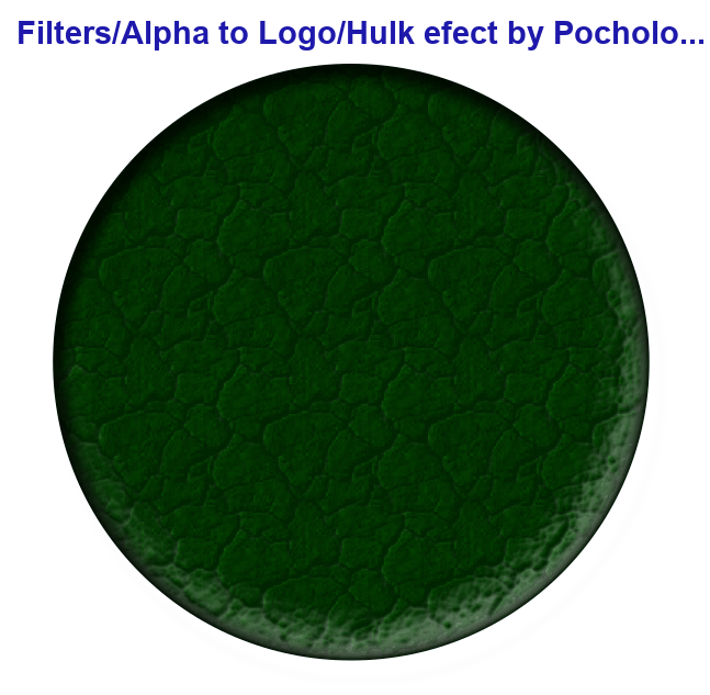

PostPosted: Wed Aug 12, 2020 7:23 am  (#13)
Hi Pocholo.
I quickly needed such an effect so I added the Filters / Alpha to Logo / Hulk efect by Pocholo option ...
You didn't add a download package - so I add.
I hope you won't be offended by the attention: maybe you will add this option to your other plugins?
The speed of execution is acceptable - I know much slower ones.
