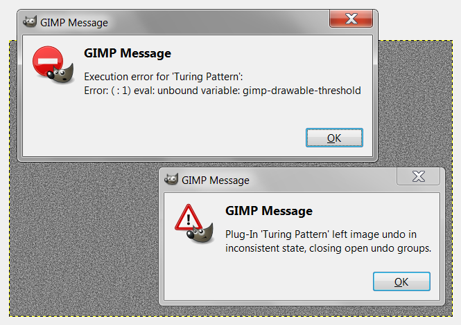

I tested your script - in 2.8 i got an error and in 2.10 nothing happens at all. The script runs and leaves the layer in the state it was at the start.
You should probably also tell us in your first post that your script requires RobA's high pass filter script to be installed, because most of us dont look at the code.

I get:
Error while executing script-fu-turing-pattern:
Error: not enough arguments
This is in 2.10.20 and I have Rob's high pass script. The high pass script works fine on it's own.

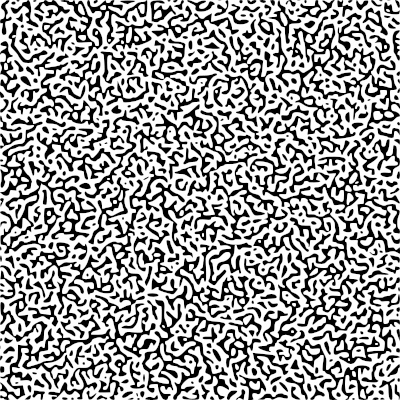

:tyspin Nice to have Turing Pattern on Linux.

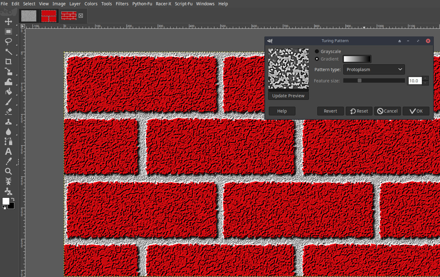

Thanks rich. Using the "Protoplasm" option makes for a good bumpmap to use on bricks or stucco.

I am investigating the error reported by Konstantin and Pocholo (it seems to be the same problem, while Mahvin's error seems different). The difficulty is that I cannot reproduce this error; on my computer (windows 10, GIMP 2.10.6) everything works fine. I will try to update my version of GIMP (since it is not the latest) to see whether I can reproduce this error.
The error regarding gimp-drawable-threshold being unbound suggests that there is no procedure named "gimp-drawable-threshold" in the pdb. Could you check this, Konstantin? (filters > script-fu > console > browse, then look for a function named gimp-drawable-threshold). Pocholo, is it the same error message that you get?
Yes, its there.
I was somewhat able to fix the problem.
It worked after i installed the high-pass file provided by mahvin. The reason it wasnt working is because i had edited my version of the script so it appears under "Enhance" instead of the "Generic" category.
However: it still doesnt work when "Create new layer" is unchecked. That will only produce a white layer.
