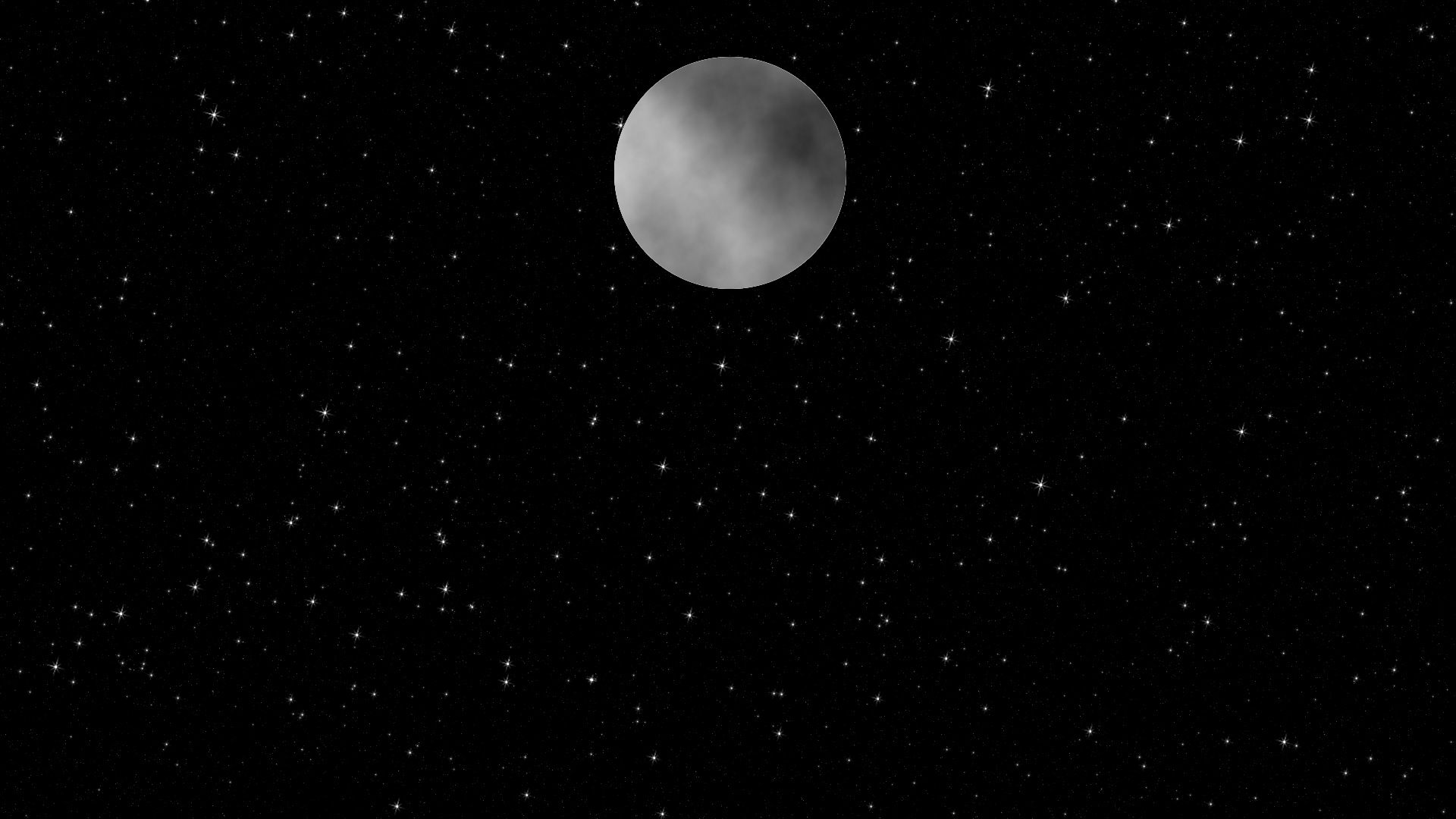

 Post subject: Re: Inserting pdb.python_gegl command in my code (Solved)
PostPosted: Sun Jan 30, 2022 11:10 am  (#9)
Stopping before "gegl" I get this image:
PostPosted: Sun Jan 30, 2022 4:46 pm  (#10)
Sorry I had to stepped out. Wi the first Bump-map "gegl" and the "Moon glow" this what you supposed to get with no error.
After the glow I want to use Solid Noise "gegl" in a whole layer and I don't know what I'm missing in the this gegl
line. It does not produce anything when it should give me a layer filled with Solid Noise.
