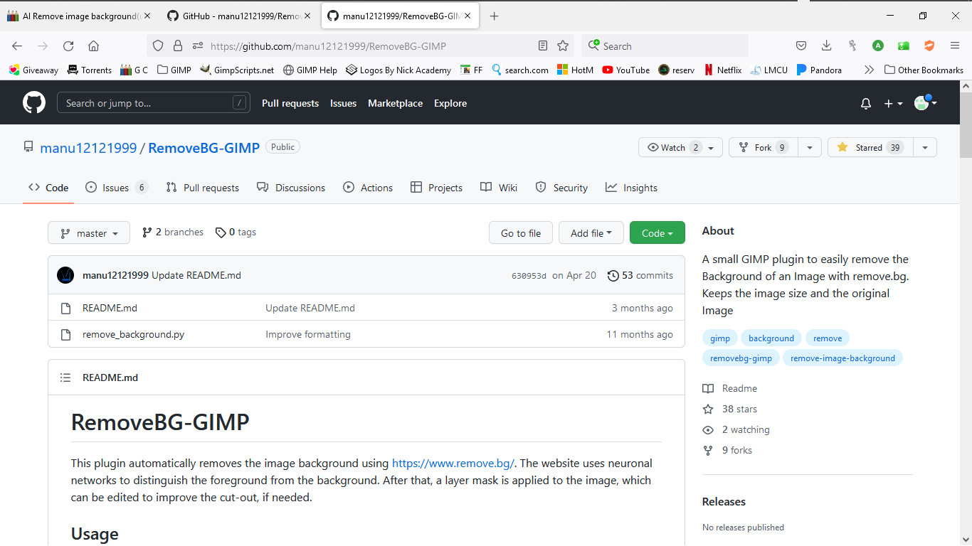

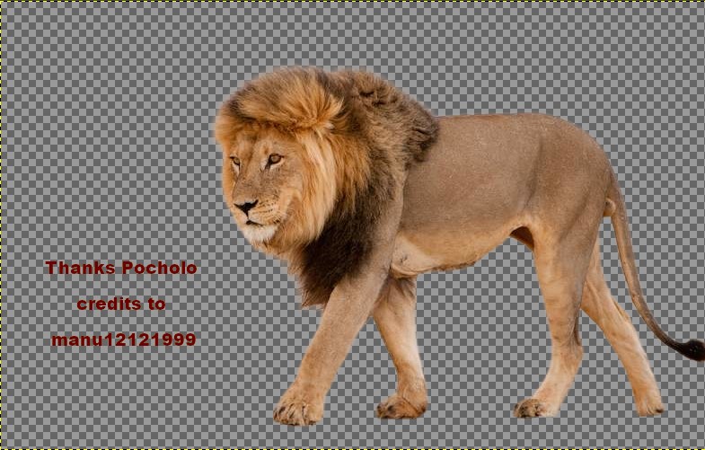

This is for Windows but you may try it in other OS. This plugin really work.
I found this plugin a few months ago at a website call "romove.bg" and sent me to download a GIMP plugin from;
https://github.com/manu12121999/RemoveBG-GIMP
I downloaded it and installed it, then I signed (you have to sign up) and you get a key code, to make the plugin work. Once you get the "key code", save it in your desktop with notepad. As long as you have this key, you can use the plugin and you can erase the background within the GIMP program.
The photo is from https://www.krugerpark.co.za/africa_lion.html

Posts: 14263
:clap :clap :clap
