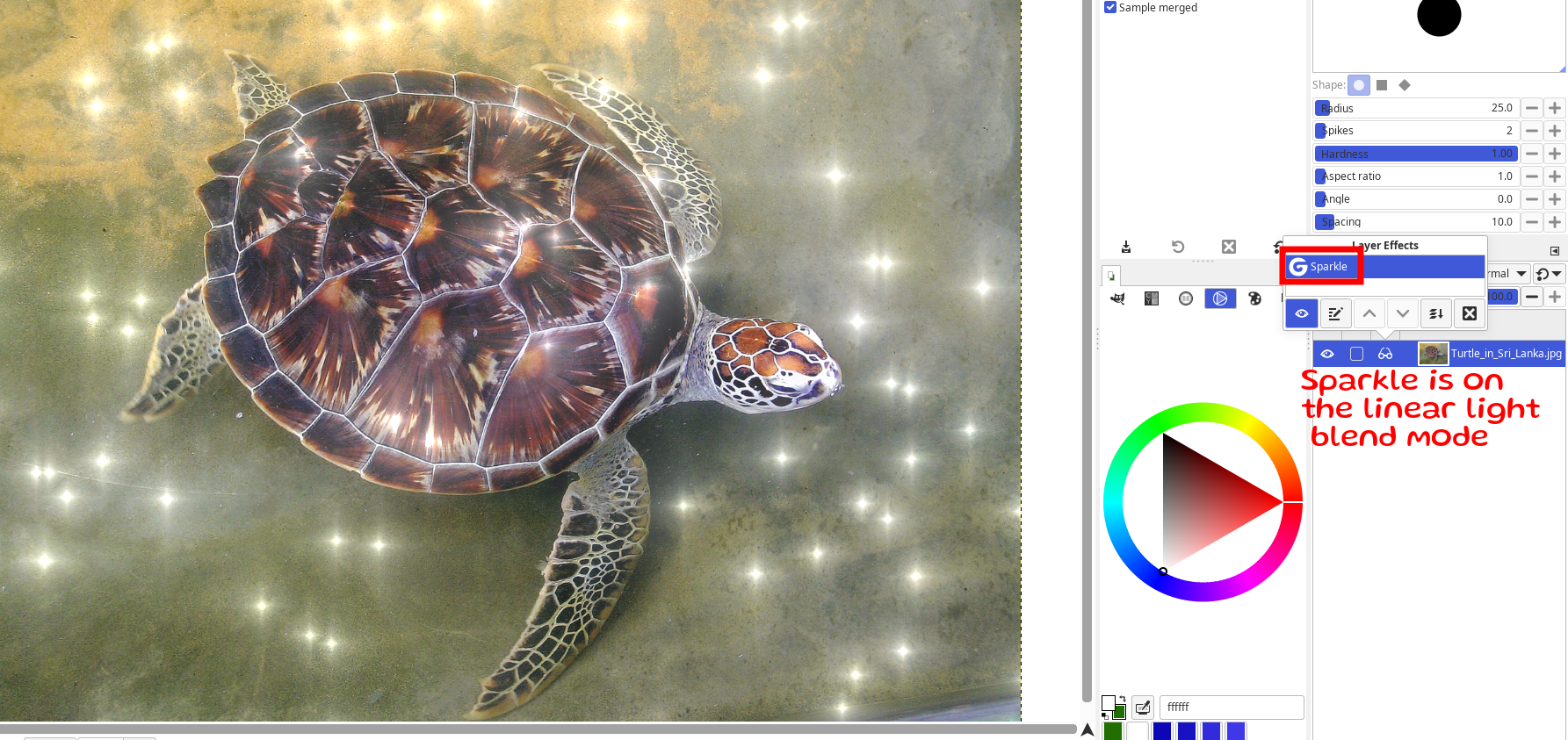

My Sparkle plugin running non-destructive with the linear light blend mode.
https://github.com/LinuxBeaver/GEGL_Spa ... /releases/

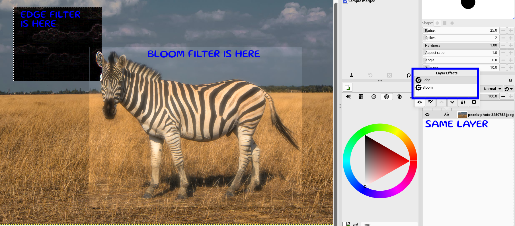

The rectangle select tool and other tools like it can make selections and then we can apply GEGL filters non-destructively, but what is very impressive is that GEGL remembers where the selection is applied.
In this picture the Edge Detect filter (Edge) and a orton glow filter (Bloom) are both on the same layer and selections
that were made with Gimp's Rectangle Select tool are remembered.

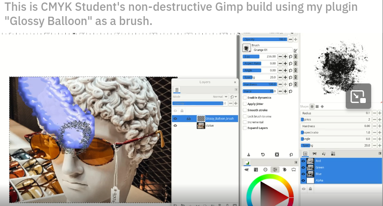

Here is a video of my plugin "glossy balloon" being used as a brush.
https://www.reddit.com/r/GIMP/comments/ ... imp_build/
Download to Glossy Balloon is here but note it is destructive in Gimp 2.10 and normal 2.99
https://github.com/LinuxBeaver/GEGL-glo ... xt-styling

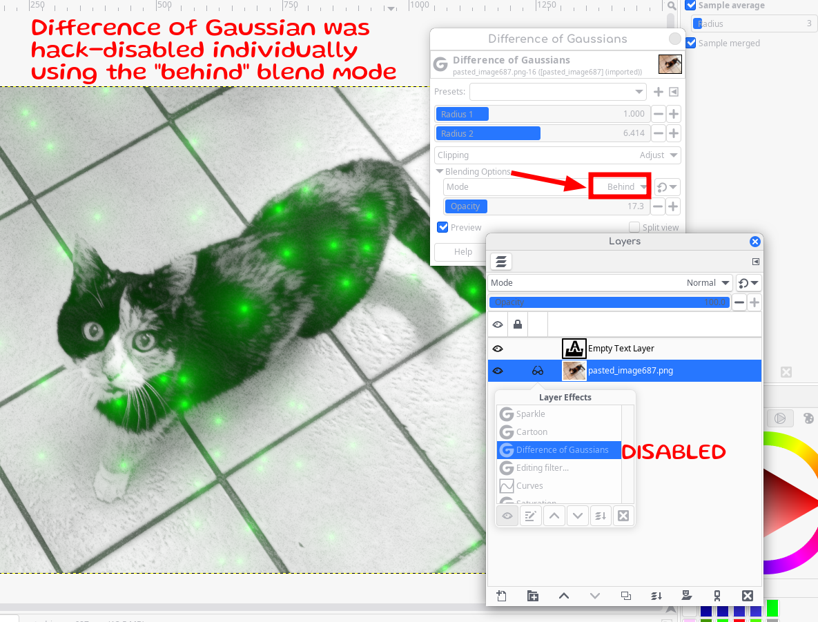

Filters cannot be individually disabled yet, but they can be "hack-disabled" by setting them to the behind blend mode.
I guess this won't work on images with transparency and filters that generate rendered fills (like cell noise and spiral). In that case set their opacity to 0.

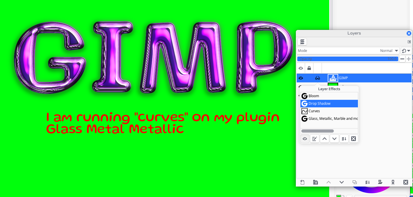

Here is my plugin "Glass Metallic Marble" being ran with curves on top of it. Curves cannot be ran inside GEGL Graph so this is an interesting thing I have going on.

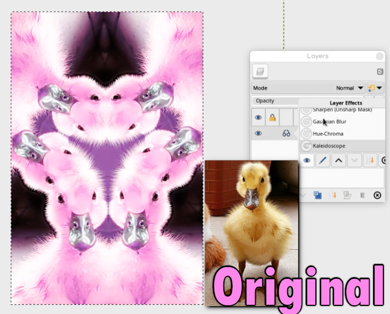

Here is me applying Kalidescope, Hue rotation, Gaussian Blur and Sharpen together as "layer effects".

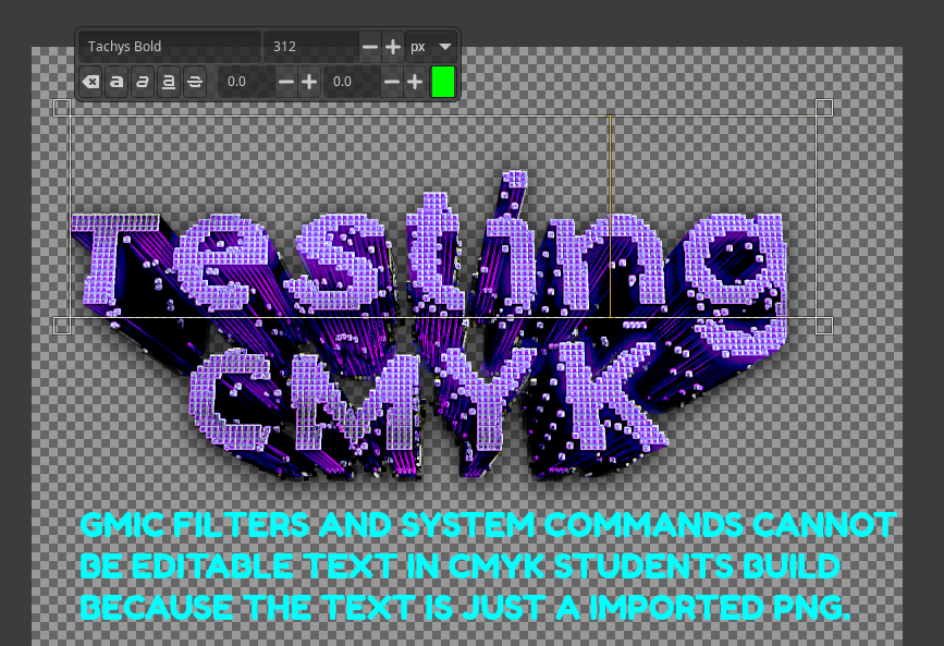

ok, I just confirmed that my bash plugin that can call AI and GMIC filters does not allow editable text with CMYK Student's build. If you try to edit the text it shows the text box but no matter what you type nothing happens. It only shows the original text that the filter was applied on. The reason why this happens is obvious, because the text is an imported png from GMIC or whatever other app outside of Gimp. GEGL text is editable because GEGL is actively running on the text layer. The imported bash command is just GEGL importing a png from the /tmp/ folder.
